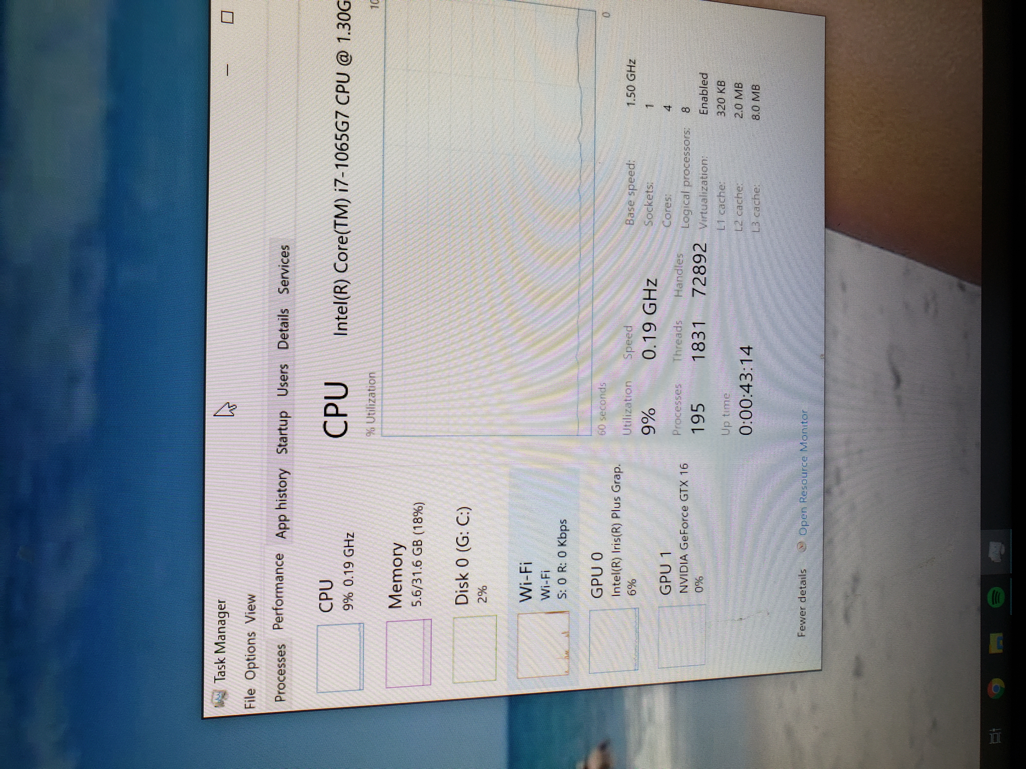

    2020-06-10T04:05:07+00:00
    Just opened task manager
