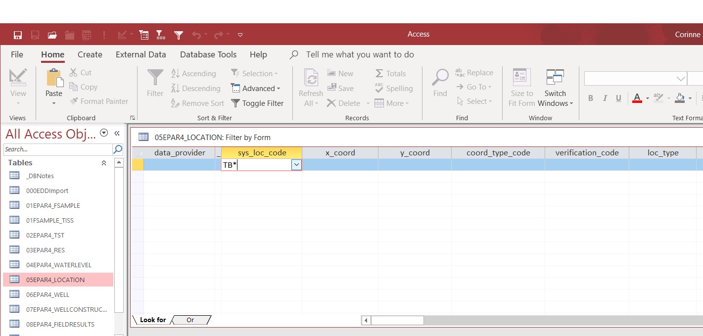

    Below is an example of a filter that will crash the software.
    Table name: 05EPAR4_LOCATION  with 688 records.
    Open table in browse mode.
    Select Filter by Form from the Home Button bar (I also have some quick buttons set up above the menu).
    Enter a criteria as follows into a field called sys_loc_code:   Like "TB*"
    Select Apply Filter/Sort.
    A spinning wheel shows that the filter is in progress and then the software will crash.  The software will automatically restart and will have copied the database to a file with "Backup" in the file name.
    Image of the query is shown below:
