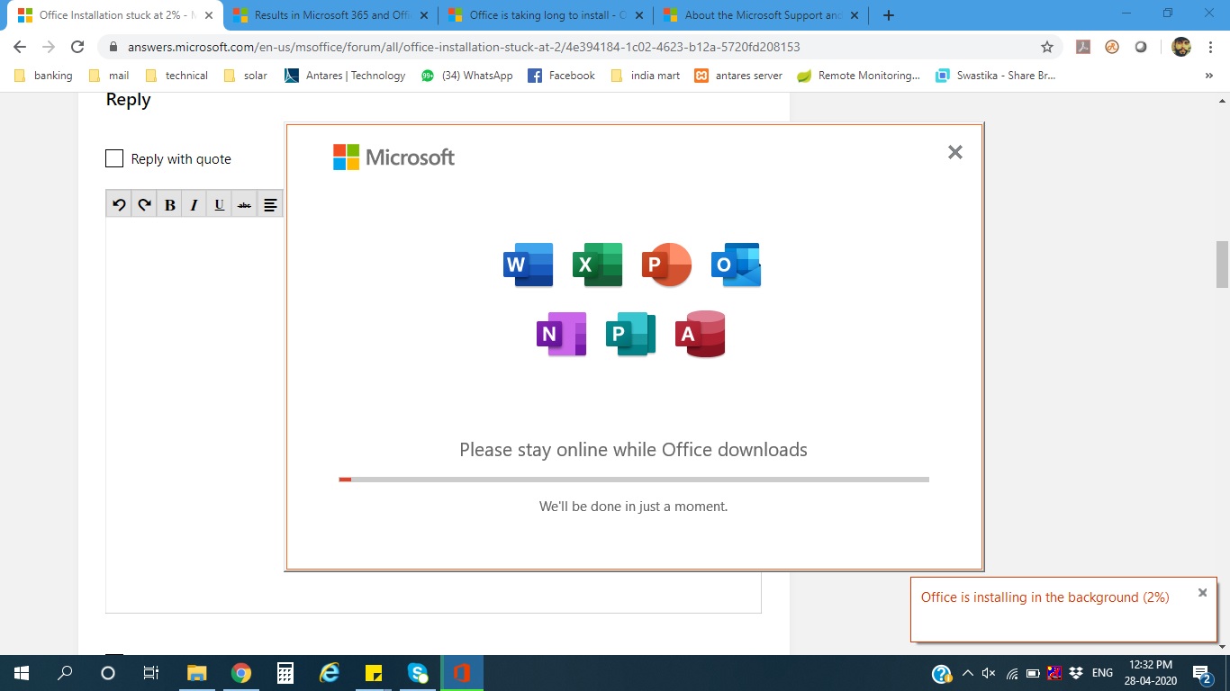

    what is solution for this error, we already purchased 6 user office but can't download this
    This solution does actually work, I figured out that in some cases you don't even have to end both process, just the one taking up more RAM. One you do there is a good chance that the status bar will drop form 2% to 0%. This is a graphical bug, just get up and get some lunch or something, and eventually you will get a message saying that office was installed correctly. Please note that once the bar drops to 0% it will stay there and you wont be able to track the actual progress of the install, but it is still installing in the background. It is also worth mentioning that this will take slightly longer to install, most likely because killing the click to run causes the install to hang in the background temporarily. It will recover though (assuming you don't click on it) and continue silently installing in the background.
    On a side note, I have not idea why everyone keeps calling the process "oneclick ", as this is not the actual name of the process. Look for a process called OfficeClick ToRun as shown below.  There will be 2 of them, plus the actual installer process (which you do not want to kill).
