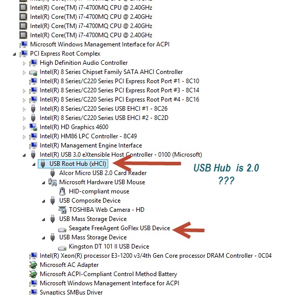

    Will make some effort researching, if no  good results, will keep on with my USB2 High Speed Port, Indeed.
    Strange, I have no Enable xHCI USB 3.0 in my BIOS. I have Disabled USB Legacy Support.
    This is UsbTreeView Capture ... (continues...)

    JS,
    How did you "mod" your UEFI?
    HS Port stands for HighSpeed Port? Then, did you disable from BIOS port 3 & 4?
    I imagine this could be my problem ...
    I cannot make my Seagate External Disc to work in USB3 SuperSpeed Mode ...
    Did you meant that it should be under EHCI, to work for USB3 SSpeed?
    I really appreciatte your help, this might be a tiny light at the end of this dark and bloody tunnel ... ;)

         Hey! Hopefully I can help you with this... Let me explain... First of all YES I did "Mod" my UEFI/BIOS... Now attempting to "Mod" any UEFI/BIOS IS VERY DANGEROUS & RISKY!!! In my case I have an AMI BIOS... There are tools available for modifying AMI UEFI/BIOS... Can you tell me what UEFI/BIOS you have please... As well as your PC Specs please...
         Second, Yes HS means Hi-Speed Port... You see xHCI (USB 3.0) Controllers are backward compatible with USB 2.0 (Hi-Speed) devices so xHCI topology INCLUDES 4 HS Ports that are PAIRED with the SS (SuperSpeed) Ports... For a total of 8 xHCI available ports... So yes what I did was Disable xHCI HS Ports 3 & 4 in the BIOS... I recommend you download this tool: UsbTreeView... Here's the link: http://www.uwe-sieber.de/files/UsbTreeView.zip With it you can see how your USB Controllers & Stack are set up...
         Now, what are the specs for your external Seagate HDD? Is it USB 3.0? I think that in your case you have to Enable xHCI USB 3.0 in your BIOS... Set it to Enabled or Auto... And maybe Disable USB Legacy Support... In my BIOS I unlocked a EHCI Port Switching function... That in some cases routes USB 3.0 devices to the EHCI Controller...
         After you download and run UsbTreeView... Post a screenshot of your findings please... So I can see if I can and how to help you... ok... And Also please post screenshots of your UEFI/BIOS... Any areas that contain USB Settings ok... please...
