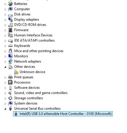

    Hi ,
    I have a HP Pavilion 15-p228tu purchased 3 months before, suddenly all my usb ports and camera stopped working.
    I am trying to fix my USB ports first.
    I have 2x3.0 and 1x2.0 USB ports, when i check my device manager i am not able to see more that one usb hose controller there, see pic below.
    I tried to uninstall the driver, update the driver, no luck. I get message "your computer dose not meet the minimum requirements for installing"
    Also I tried uninstalling am windows update KB2984006, Strange thing is I purchased my computer in March 2015 and this update was installed sometime in Jan 2014, and I cant uninstall the update,How come, the update is installed before I purchase the machine? Are they cheating me??
    Please help me to resolve the issue.
