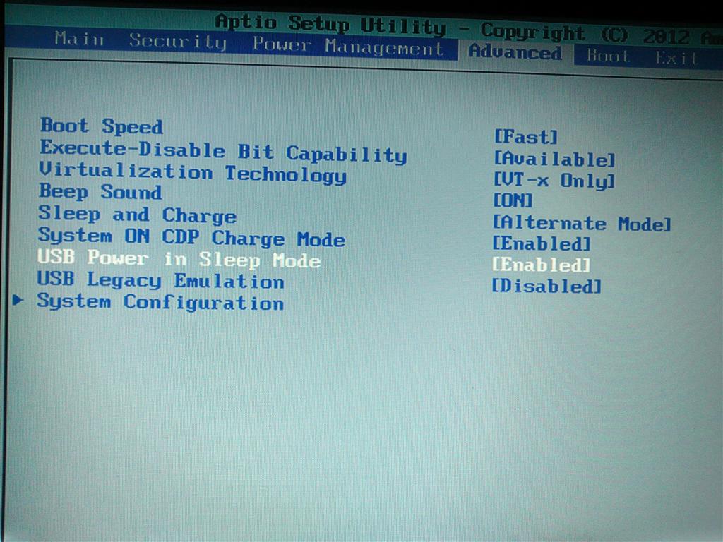

    2 of 3:
    2014-04-04T20:54:59+00:00

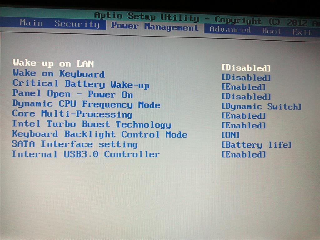

    And these are my BIOS captures:
    2014-04-04T20:53:27+00:00
