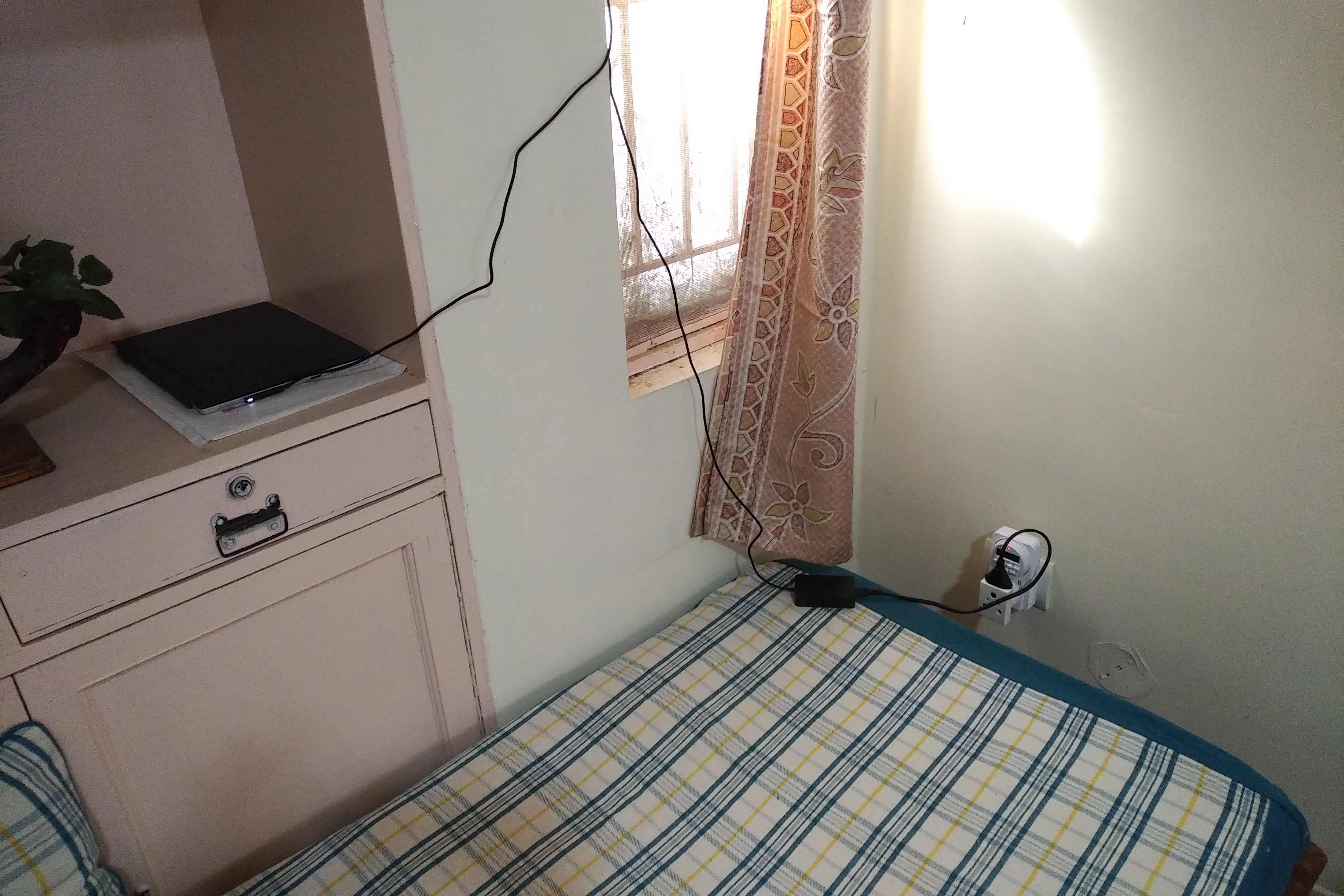

    The  Programmable power supply on off timer arranged as shown in picture for charging weekly once so that when I really need it (its requirement comes suddenly , may be monthly once for 1 or 2 hours) , it will not be in deep battery dead condition (which itself needs more than 4 hours charging to just on the surface)
    the time is programmed to auto on every wed 7am and auto off 10 am (selectable any week or time)
    Regards
