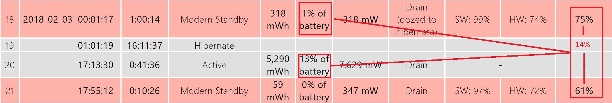

    As an experiment, to try what someone else in the thread earlier tried, I used up the charge on my SP4 to the point where it was down to 4%.  Then from there, I attached the power supply and charged the SP4 back up to as far as 97%.  Then I did a full shutdown.  Again, I had already disabled modern standby (partly because of not wanting the feature and partly because of troubleshooting this issue of the battery discharging while the SP4 is off).  When I then powered back on the SP4 nearly 16 1/2 hours later, the charge was at 91% (down 6%, even though the SP4 was completely off for almost 16 1/2 hours).
    In case one wants to look at the logs, I have shared the battery report and sleepstudy report files at the following links...
    http://www.mediafire.com/file/3ek8736yh7ajx4j/battery-report.html
    http://www.mediafire.com/file/veqprvekn8rnb5c/sleepstudy-report.html

    I was thinking, since my battery does not drain while in hibernation, maybe a compromise.
    Mike, set you system up normally and do not try to shut it down.  Then set the connected standby or disconnected standby and set it to hibernate after 60 minutes when on battery.  If you system is draining when shutdown, it should also drain that same amount during hibernation.
    When you are ready, let the system sit on battery until the display turns off.  Since it will be in Modern Standby, let it sit for several hours or overnight.
    After the period, wake the system up with the space bar or pen or possibly power button.  If it is in hibernation, it will probably require the power button to wake it.  Then do a Sleep Study we can see or place it on your OneDrive so we can download it.
    Since I have done so much testing on this situation, I should be able to see for sure what it is doing.  If we see the system "dozed to hibernate" and still see a battery drain after that time while in hibernation, then something is draining the battery.
