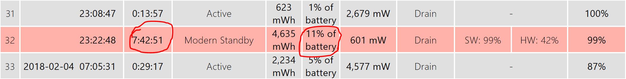

    2018-02-05T19:00:29+00:00
    Mike, the attachment shows my system with its current configuration.  The 11% battery drain is normal for that configuration.
