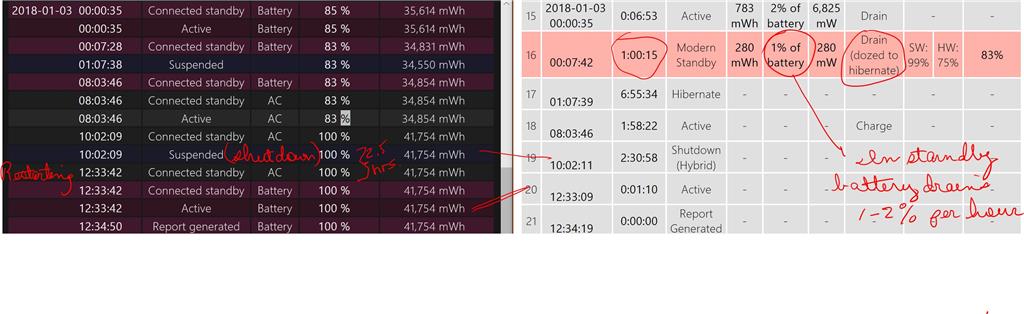

    According to your attachments it appears the battery is draining when shutdown, as you believe.  It would have been nice to see a larger sample.  I have shutdown my system in the listing below for testing, which I normally do not need to do to conserve the battery.
    I do not know if the Surface Pro 4 does modern standby and if not, my comments are not really relevant.  If you have hacked your registry to allow your system to sleep then your observations are not accurate.
    What bothers me is the battery drain you show is in line with what I show when the system stays in a low power mode.  Is it just a coincidence or are the drains related?
    I am attaching my listings so anyone wanting to check their system has something to compare.  A Surface system may report differently than my system.

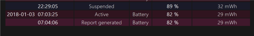

    2018-01-03T06:17:04+00:00
    This is my report from my surface pro 4. As you can see in the attached images, mine has a battery drain while powered off.
