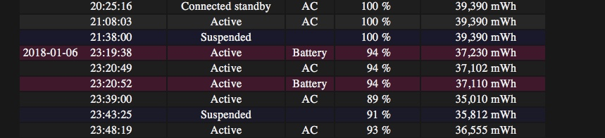

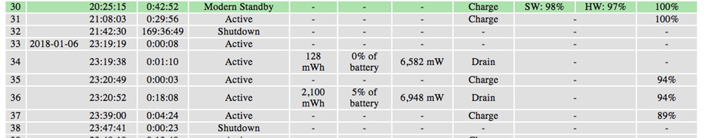

    According to with I said in my previous reply I did some test with the last replacement SPA that MS sent me by Dec 14.
    First, to answer to your question I did Surface diagnostic toolkit with no errors report.
    Here is my test :
    • clean install (latest with mediacreationtool) + drivers update.
    • full charge (SP4 was empty when unboxed)
    • battery was 100%
    • shutdown with shutdown -s command by dec 30 2017 at 21:38:00 (see pict. battery report and sleep study)
    • restart by jan 6 2018  at 23:19:28 (see pict. battery report and sleep study)
    • powecfg (batteryreport and sleepstudy
    - battery is 94% after 1 week off
    power cfg
    Sleeptudy
    With another PC bought brand new same period (a few days after I sent back my just received SP4 for screen flickering problem) I still got 100% after one week.
    Like me previous SP4 I also have a strange setting in power recommended mod ( when you click on battery icon) : cursor is set to right on max eco mode when on AC POWER (lowering screen light) and set to middle (with stronger screen light) when on BATTERY.
    As this behavior was the same on all my surface I suppose that it is an endemic abnormal behaviour.
    One year with this surface now just playing beta tester for MS. I am really upset.
    According to french law this might be a reason to sue MS for a refund.
    I would like to stop spending time on forums and with support sending surface back and forth and receive from MS a real answer.
