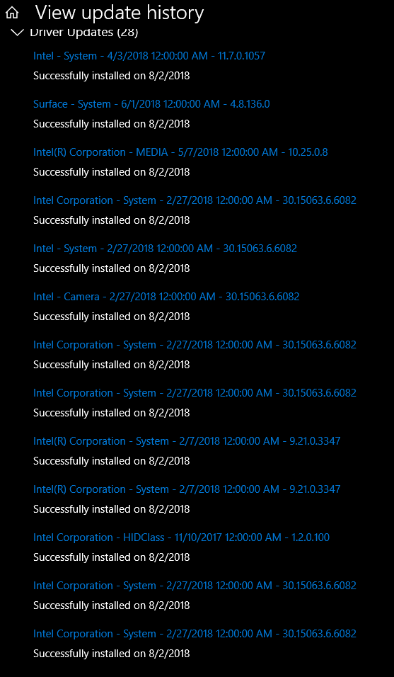

2018-08-03T21:50:10+00:00 I tried the insider program a while back, that did solve the lag problem mostly for me but caused many other issues since it is beta. I did get that batch up surface and intel updates yesterday as well. That actually did seem to solve many of my problems. I can now run Hyper-V while on battery in any power setting and the lag appears to be gone. I do still see lag when task manager is running though, so it's not totally solved but much better. A new problem I had after the update was a hard lock-up every time I would wake the surface book while on my surface dock. I found this to be related to using a 4k monitor over display port. I have since replaced that mini display port to display port cable with the official microsoft mini display port to hdmi 2.0 and all is well there now too. Of course it hasn't been a full day yet, but I'm hopeful that I'm potentially seeing an end to this issue.

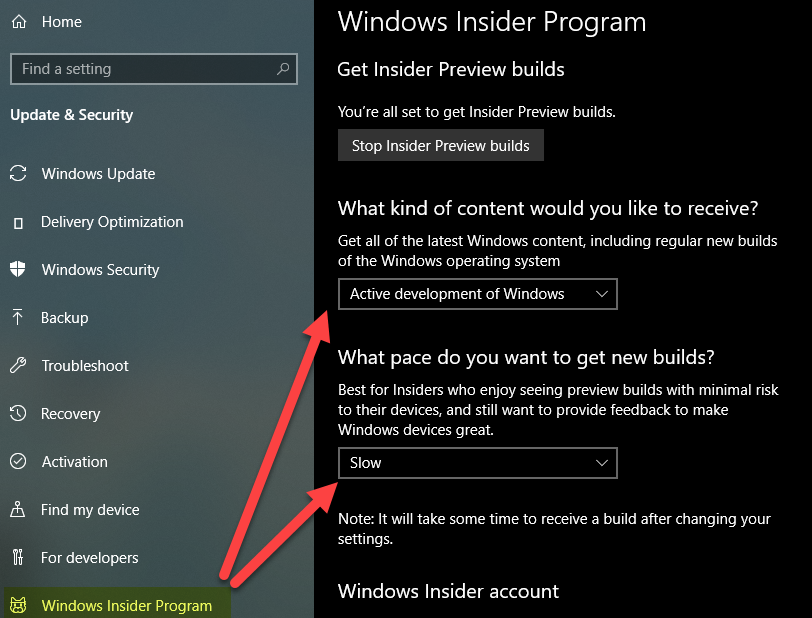

2018-08-03T19:35:01+00:00 Something interesting. As I mentioned earlier, I am in the "Windows Insider Program" slow mode. I think anyone can join and slow mode seems to be pretty safe but of course it is still beta software so keep that in mind. The latest build they make available here seems to really help this "lag" problem but something interesting happened yesterday and I'm not sure if all Surface Book 2 owners saw this.
Windows Update downloaded almost 2 dozen driver updates for everything imaginable on this machine. It also installed a firmware update yesterday and another one today. Every possible Intel Driver and the NVidia driver were all updated. Somethings going on for sure. Anyone else experience this?
