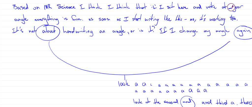

    I picked up a i5 128Gig SP3 three weeks ago. I get the same kind of issue. As often as not, my drawing/writing gets a tremor-effect. In the image below, the first circled word, 'about', is my normal handwriting.
    The next word on the line 'handwriting' starts to show some issues, then it seems to lessen/vanish, only to reappear at the end with the circled word 'again'.
    The best example is the last circled word 'and'. it's both tremored (tm) and also floating above the ruled line.
    It happens in the metro version of Onenote, as well as Manga studio. I don't know if it's occcuring more when the SP3 is very warm... I've tried changing my hand placing (I thought it might be related to the palm rejection tech)... I'm going to try returning/replacing mine. I've already tried replacing the Pen, replacing the pen battery, factory resetting and re-updating.
