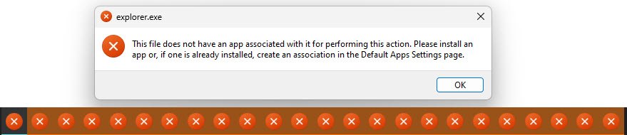

Hi all, if you have been getting this image/pop up
Explorer.EXE This file does not have an app associated with it for performing this action. Please install an app or, if one is already installed, create an association in the Default Apps Settings page.
We are pretty sure it is due to OneDrive.
What the issue is with it - we are not sure - any ideas on how to fix this, that would be great!

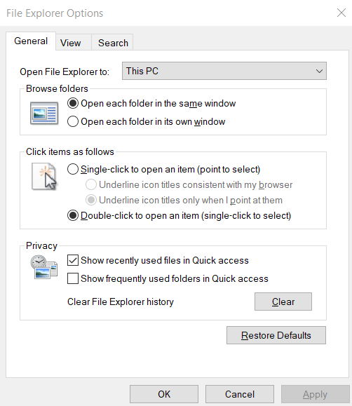

    Try these two things:
    1. Search and open "File Explorer Options"
    2. Select an option in the "Open File Explorer to:" drop down menu
    My drop down menu was blank. When I selected an option, the issue was resolved.

    I've been having the same problem and keep getting these pop-ups at random. After some googling, I found this blog post that has a few solutions to try. The only thing I could try was updating File Explorer Options to open file explorer to This PC per suggestion number 4. Maybe this will help?
    https://www.koskila.net/how-to-fix-this-file-does-not-have-an-app-associated-with-it-for-performing-this-action-in-windows-10-11/

    2024-05-21T05:59:21+00:00
    It is getting worse. This appeared overnight. 24 of them. Normally I get 6 or 8.
    It would surely be helpful for the debugging if Microsoft would modify this error message to say which file.
