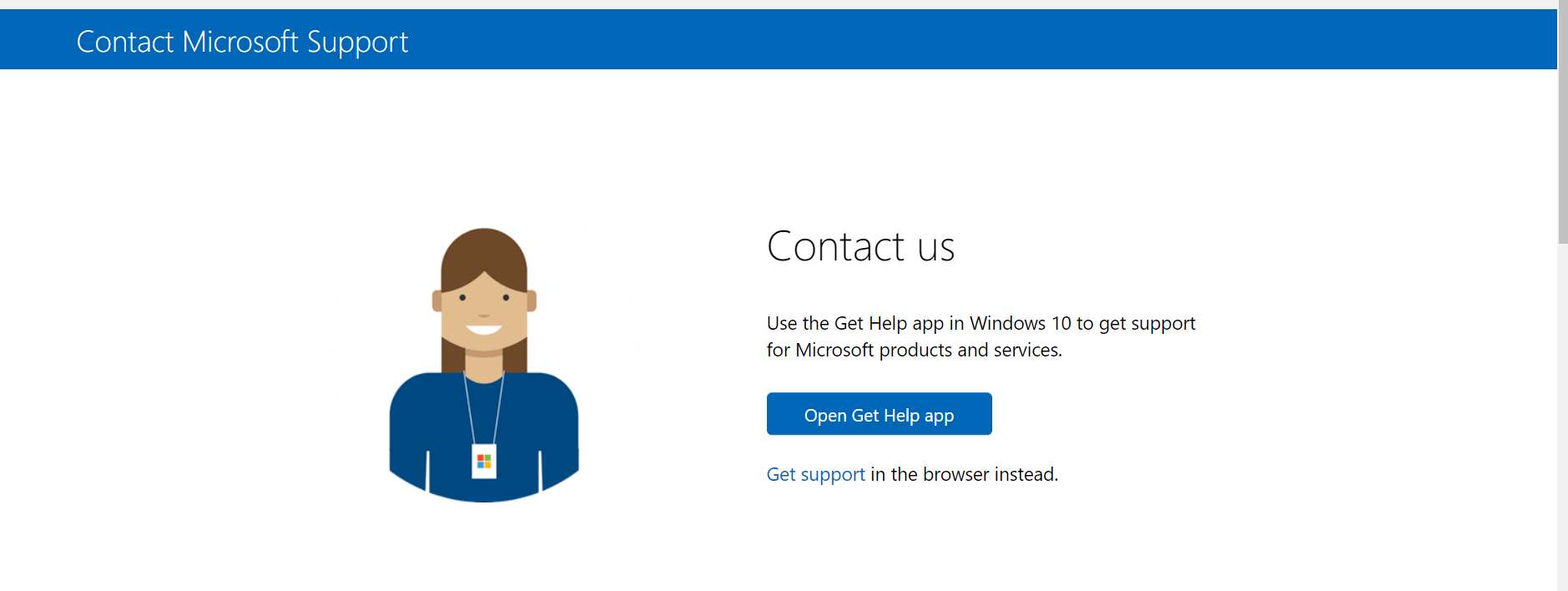

    Finally, I got my problem resolved by contacting the Microsoft support team via the "Get Help" app that comes with windows.
    This was the solution:
    1. The support team member asked me to log out from the office (by logging out from word).
    2. Then close the Word app.
    3. Again login into Word app with your Microsoft account, this will you give a prompt to activate the office.
    4. Click "Activate" and done!!!!.
    This was a quite simple solution, but I am not sure if that support team member team did something at her end. But Definitely, you can try logging out and then log in again to the office.
