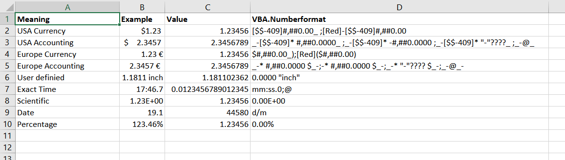

    potential problems:
    https://www.dropbox.com/s/m4uowix6w6v9bcu/92305791-a4c1-4aa5-b19b-88d541a9a677.xlsm?dl=1
    And using the .Text property is always critical, because if the column is too small you get #### instead of the value on screen. This issue often occurs if different people edit the same file if they are using different screen resolutions.
    I just want to point this out to the following readers, because IMHO this is far away from watertight. :-)
    Andreas.
