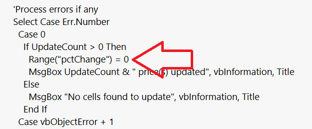

  1. Andreas Killer 144.1K Reputation points Volunteer Moderator
    2022-01-24T04:50:59+00:00
    One request: Your macro "RoundCurrencyValuesAsAppearOnScreen", when run, zeros out the field "pctChange". Would it be possible to modify the code such that whatever % I have inserted in box "pctChange" is not zeroed out?
    Sure,
    simply delete the line
    Range("pctChange") = 0
    Andreas.
    2022-01-23T21:39:25+00:00
    I like your macro very much, Andreas.
    For instance: In tab "Sorted" I insert "6.50%" in box M2 and run your macro. When the macro finishes running, box M2 shows "0.00%". I would like to show "6.50%". That way I know what % increase/decrease I have applied to each tab.
    Thanks.
