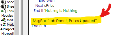

    Re, Your new request
    Add the following line at the end of the code, before the End Sub
    MsgBox "Job Done!, Prices Updated"
    End Sub
    And change the message part in red as per your needs

    I have one last request... Would it be possible to embed some code that lets me know when the macro has finished running?
