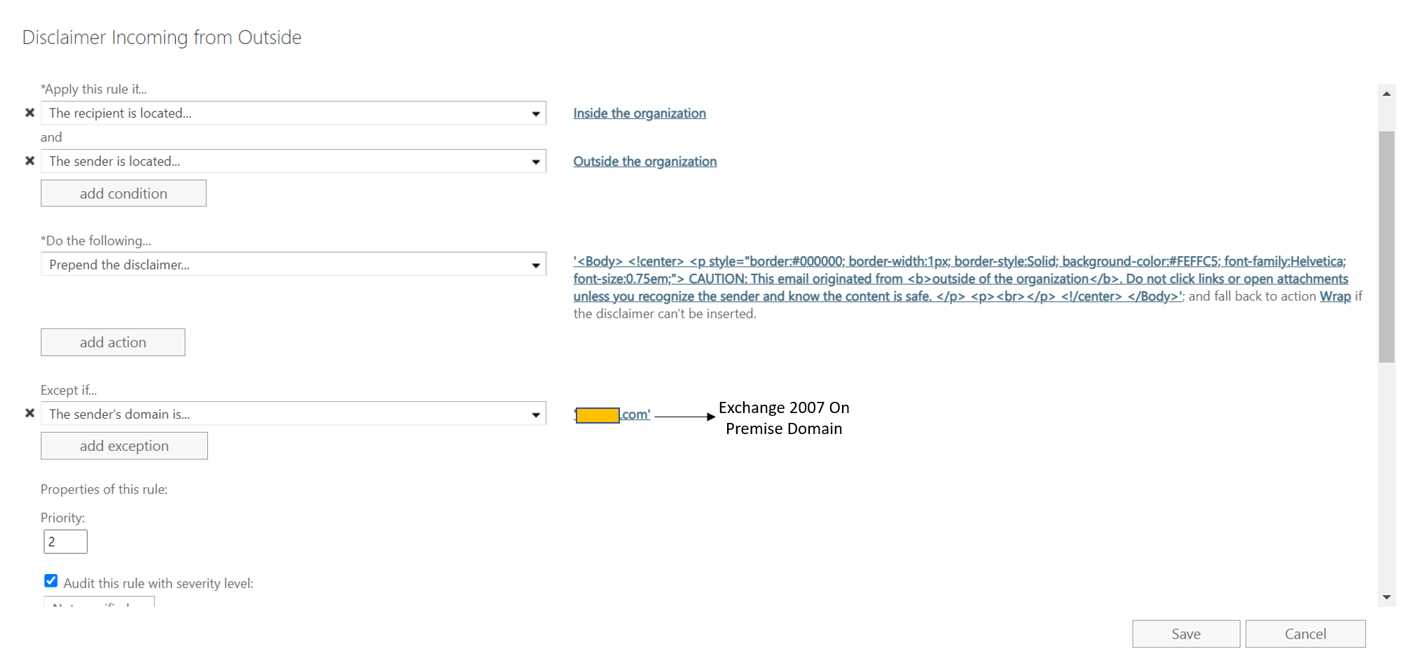

Hi BH33,
Thanks for provide the details in your post. About your question, please kindly check following steps to see if it can help you fix this issue:
  1. In Exchange Admin Center, go to mail flow > rules and then click "+" to create a new rule.
  2. Then set the new rule like below picture:
Note: in step 4, please enter following code:
<p><div style="background-color:#FFEB9C; width:100%; border-style: solid; border-color:#9C6500; border-width:1pt; padding:2pt; font-size:10pt; line-height:12pt; font-family:'Calibri'; color:Black; text-align: left;"><span style="color:#9C6500"; font-weight:bold;>CAUTION:</span> This email originated from outside of the organization. Do not click links or open attachments unless you recognize the sender and know the content is safe.</div><br></p>
