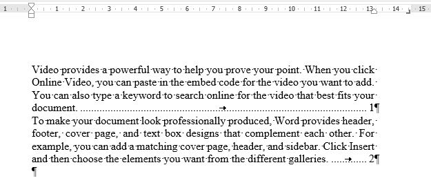

In Word 2016 (or in Word 2013 with the most recent updates) for Windows, you can set a tab stop to the right of a right indent, but NOT to the right of the right margin. This is by design. See screen shot below.
Also, you must use the Tab dialog box; you can't add such a tab stop by double-clicking the horizontal ruler.
Older file formats still support the older behavior, which is to be expected.

    The modified behavior which means that you can no longer add a tab stop to the right of the right margin is by design.
    I don't know why you can't use the ruler to set a tab stop to the right of a right indent. However, since the workaround is simple enough (use the Tab dialog box), it may never be changed/fixed. If you wish, you can post feedback on this in the Uservoice forum at http://word.uservoice.com.

    How are you adding the tab stops? Note that in Word 2013 you can't add indents to the right of a right indent on the ruler; you have to use the Tabs dialog box.
    If it still doesn't work, you have to install the latest update for Office. At the very least, you have to install the June 2013 cumulative update from http://support.microsoft.com/kb/2817342.
