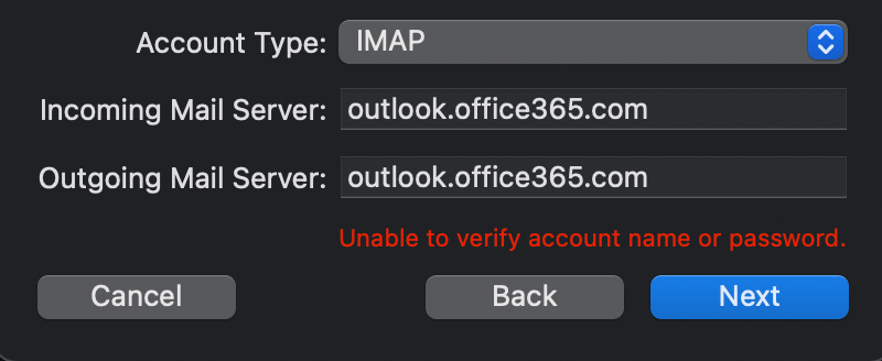

    Hello Dave R
    Hi, I'm Karl and will be happy to help you today.
    The correct settings for any Microsoft email accounts (@Outlook @Hotmail @Live @MSN) are as follows
    https://learn-attachment.microsoft.com/api/attachments/fa07d536-4f27-4a73-8054-4a733e6beb92?platform=QnA
    *** as a FYI, all email properties use the same Outlook.com backend servers which is why you do not see a specific category for @hotmail
    If you have any questions, don't hesitate to ask, we're here to help you further if needed.
    2024-01-26T00:30:49+00:00
    There are a number of server names that are being phased out in favor of the standard ones that I included which have been in effect for quite a while
    As for your screenshot - where is this from? More importantly, is there a reason you are using IMAP instead of Exchange (the default)? Am assuming this is because you're using a 3rd party email client that does not support the Exchange protocol
    Have no idea as to why you can receive emails, but the Sent Items folder is asking you to log into the account. Something is missing from this description. Just to confirm, that isn't the server name you used for the SMPT server -- correct?
