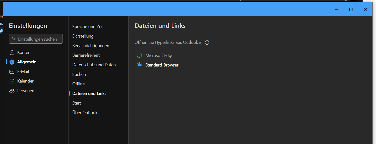

This is a new feature in OUTLOOK and has nothing to do with the default apps in the OS settings.
Go to Outlook Options > Advanced > Link Handling > "Open hyperlinks from Outlook in:" > Select "Default Browser".
