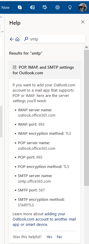

    2023-01-10T17:29:19+00:00
    @heartburn(2)") - When connecting to port 587, it's must to use TLS encryption using STARTTLS Verb (POP, IMAP, and SMTP settings - Microsoft Support). So this error is expected. If you want to connect using Non TLS, you can use port 25.

    2023-01-10T15:32:53+00:00
    In the outlook wep page in the help menu, when I search for SMTP I get different information. I'll try this server.
