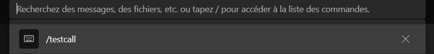

    fast call test with the command in the search bar
    Just have to type /testcall
    and this cmd will be in the list after
    Not ideal but it is the fastest tweak i found
