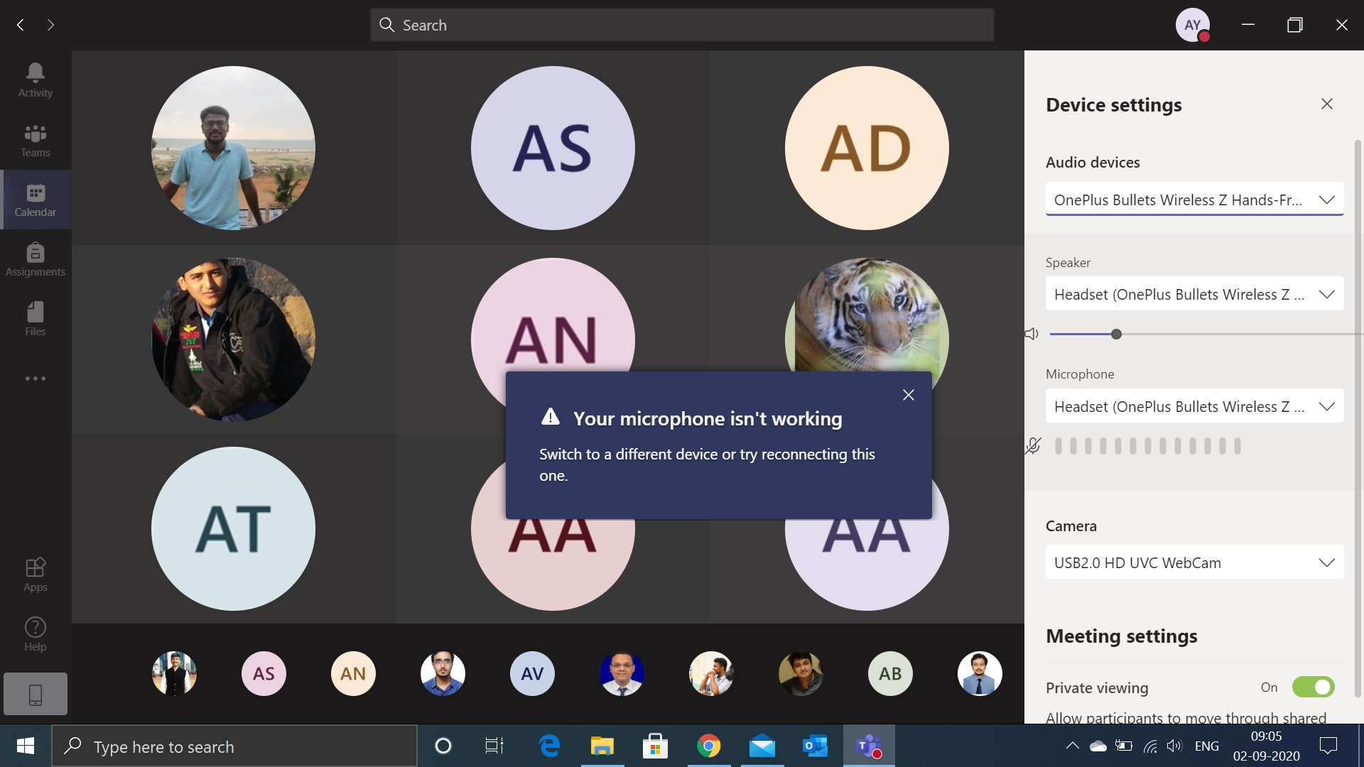

I have a pair of Bluetooth Skullcandy Hesh 3 Headphones, and they have 2 connections with my laptop.
1)Hesh 3 Stereo
2)Hesh 3 Hands-Free AG Audio
When I use Hands free AG Audio, there is some static disturbance. When watching videos, stereo option gives great sound quality but for some reason it doesn't give any sound during a meeting in teams. In device settings during a meeting, once I choose Hesh 3 Stereo, the voice just stops.

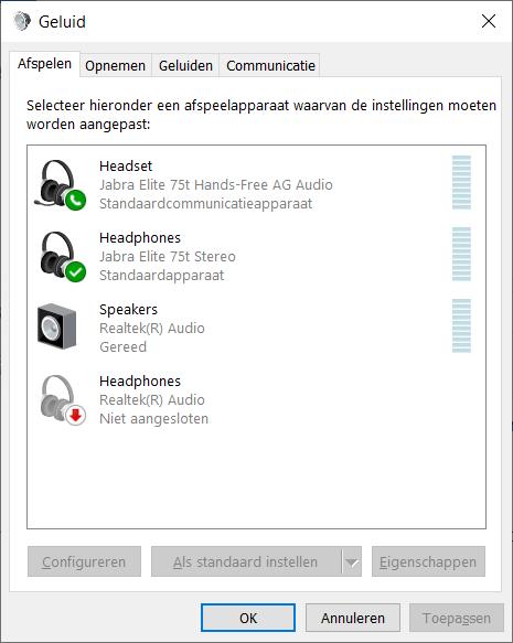

Since 2 weeks I have my Jabra Elite 75t working properly in Teams.
I use the following device in Teams:
Essential is to setup your headset properly under: windows-key + X / Settings / Sound.
Then look for "configuration" (sorry I have Dutch language active).
The configuration of Headphones (= HQ sound, without mic) and Headset (= mono sound with mic) should setup as follows:
Headset should be "standard communication device"
Headphones should be "standard device"

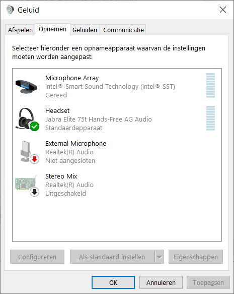

For recording (=microphone):
