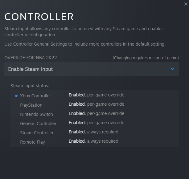

    2022-08-01T19:15:23+00:00
    i got to this work by going into steam and changing the controller steam input and it started working
