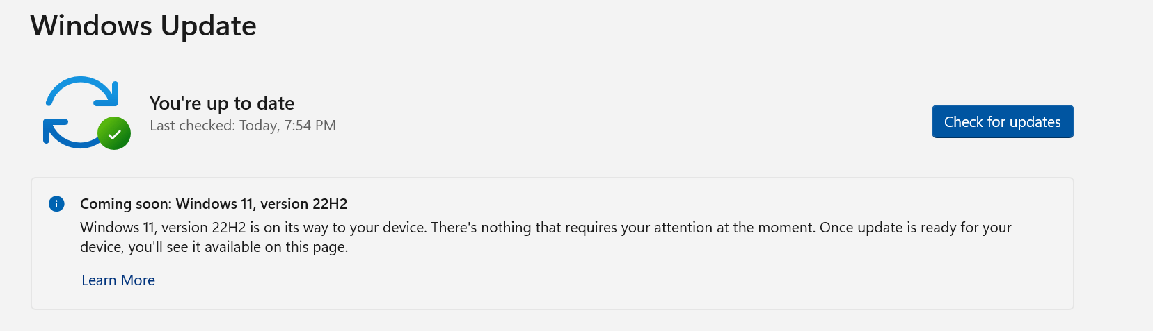

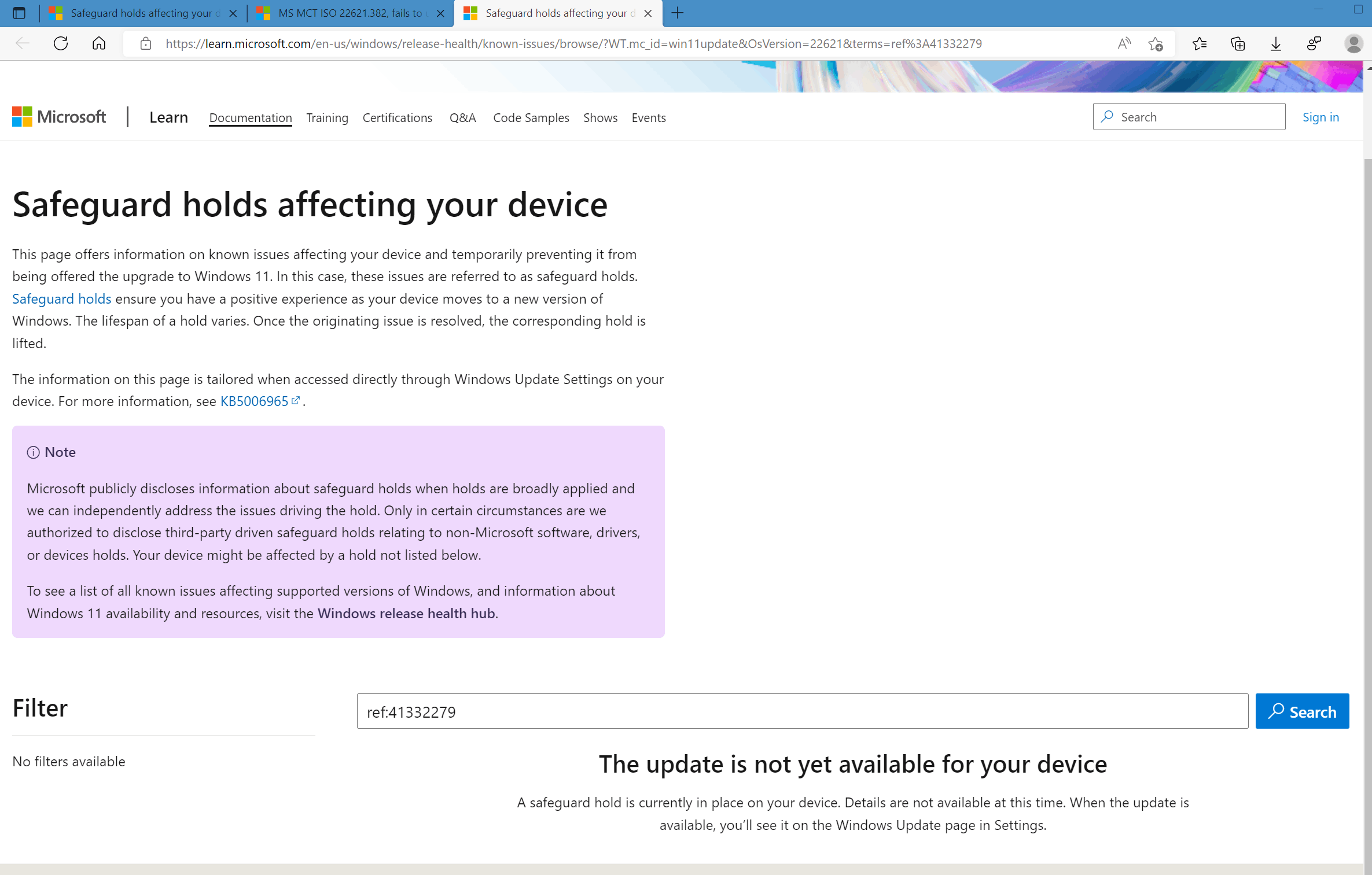

    Now today I got this message:
    The "Learn More" points to the link below which is again quite useless. 🤣🤣
    Safeguard holds affecting your device | Microsoft Learn
    Windows 10 Pre-Upgrade Validation using SETUP.EXE - Microsoft Tech Community
    This link below is pretty useless too, no explanation about the reason for the safeguard holds.
    KB5006965: How to check information about safeguard holds affecting your device (microsoft.com)
