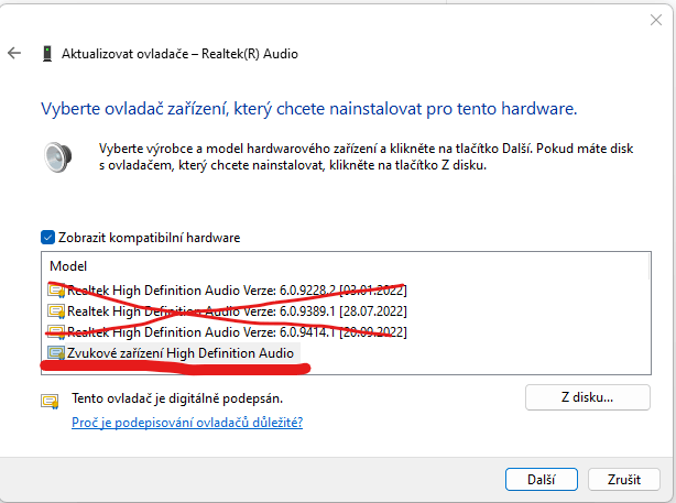

    Hallo, this is my solution:
    1. Right click on sound icon
    2. Click on Sound settings
    3. Bottom: Additionals sound settings
    4. Click on default audio output (in my case Realtek Audio) - click on properties button
    5. Click on properties ...
    1. Change settings...
    1. Update driver:
    1. Try to find new driver in PC (not automatically)
    and you can install Microsoft audio driver:
    RESTART.
    Done.
    1. Update driver:
    RESTART.
    Done.

    i just installed the realtek drivers and reboot but windows reboot installed the generic driver again (stucked in looped). So i just uninstalled the generic driver and selected the checkbox for delete the drivers from system. Then ok to uninstall and installed the realtek drivers and then reboot. It works now.
