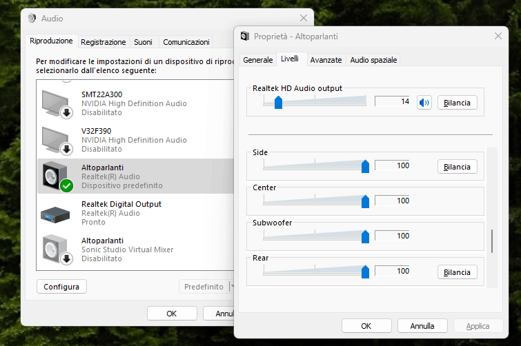

i have a fresh installed system, with:
motherboard: ASUS ROG Strix B550-F Gaming WiFi II
Nvidia 3060 v2
i have a classic 5.1 with 3 connectors, my issue is that only if a game for example cyberpunk 2077 and when i use VLC i can hear that all 5.1 channels are woking fine.
but, everywere else on the system the 5.1 doesn't work, like, firefox, spotify, netflix windows app etc...
i tried to changange some settings but nothing changed, tried to reinstall to, change the drivers but nothing to do.
tried to change setting on the Realtheck Audio Control programm, it's worst the i immagined ... the dB setting, the distance and all whe switches are not working
the only way to change the dB was to change it in the advanced audio proprieties.
My issue is that the surround system is not working with firefox, spotify and onther programs.

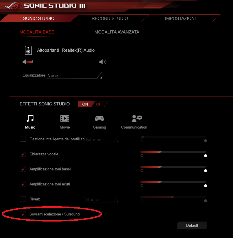

    2023-05-28T08:06:01+00:00
    the upmix option was moved in the sonic studio 3

    Just to verify, I can test my speakers using the Realtek console or SS3 and all speakers function correctly, but during playing actual media, the back speakers do not unless possibly if you had the Upmix selected in SS3. The speaker fill option seems to have disappeared.

    Sonic studio 3:
    Doesn't work with the 3.5 jacks. i have the classic 3 jacks 5.1 system. With "doesn't work" i mean that whatever settings i change, it does complitly nothing.
    Does work with hdmi output on the screens.
    Does work with with digital headset output. Don't have a digital 5.1 sound system to connect to it to try if it works.

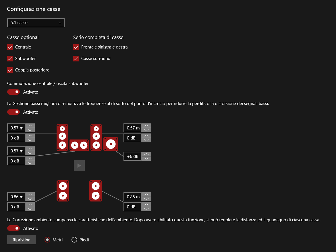

    realtek audio consol:
    Every option that you see in the screen does absolutly nothing.
    I can change between the output tipes.
    the amplify lvl works, but i can put it only on extreme, if i lower it the output is too quiet...
    i can turn off the sonic studio 3, but ... it does and doesn't do somthing....

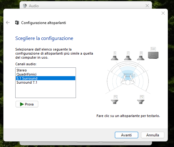

    if i press the speakers to test the audio comes out correctly.

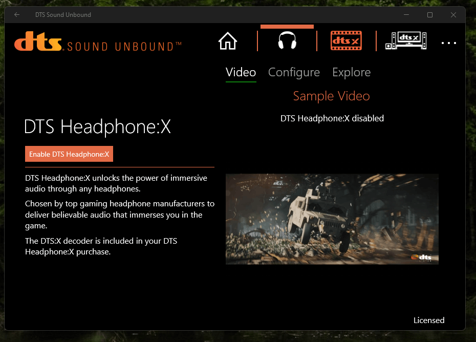

    In the DTS sound unbound, the 5.1 video demo the you find in the DTS Headfone:X setting does play correctly on all the 5.1 speakers. but only the demo video tha you fin there.

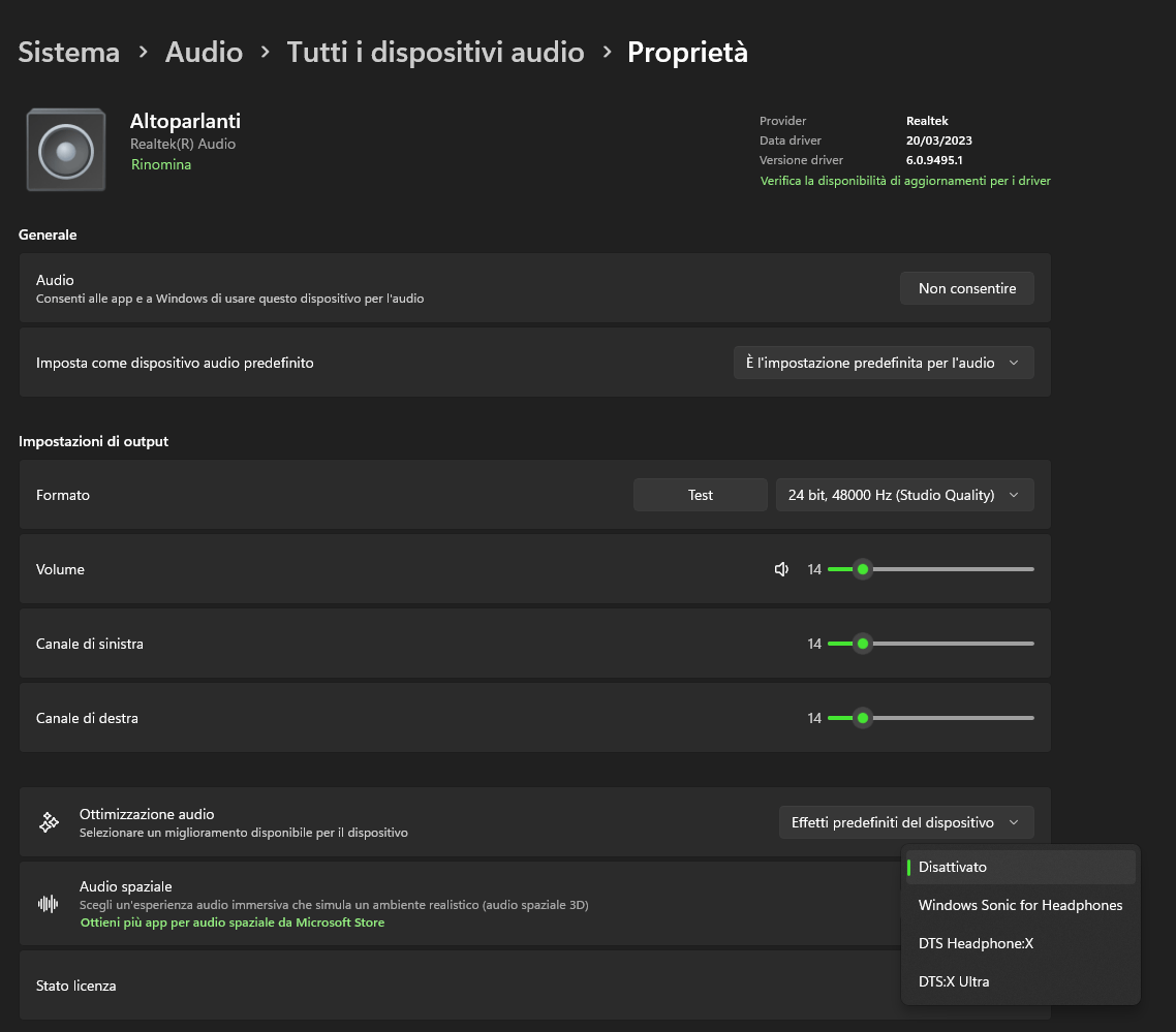

    when i try to change the Spatial audio under the windows setting do DTS headfone:X the sistem changes to stereo. And nothing like befor.
    i tried to change the settings here too, but like before.
    the only thing that i can do here is change the audio output volume.

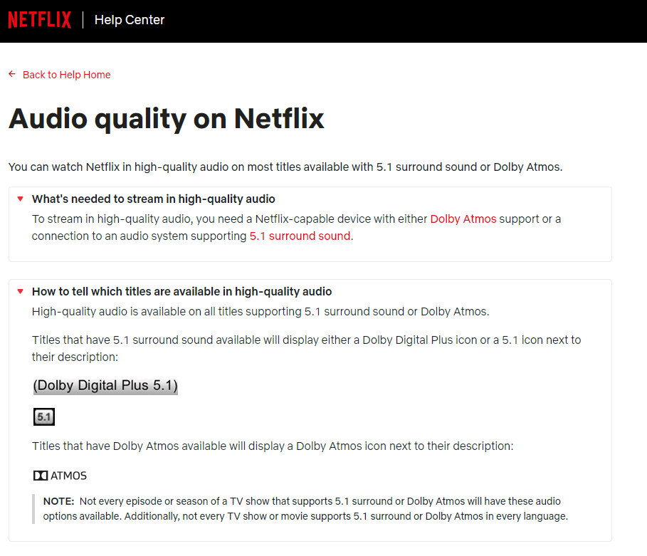

    1. Saltgrass: you are the one that is confusing other people. Most of Netflix's 5.1 is dolby digital plus --- which is compatible to the original dolby digital. Only a small number of brand new stuff have dolby atmos. New big budget movies have atmos. TV shows --- NO.
