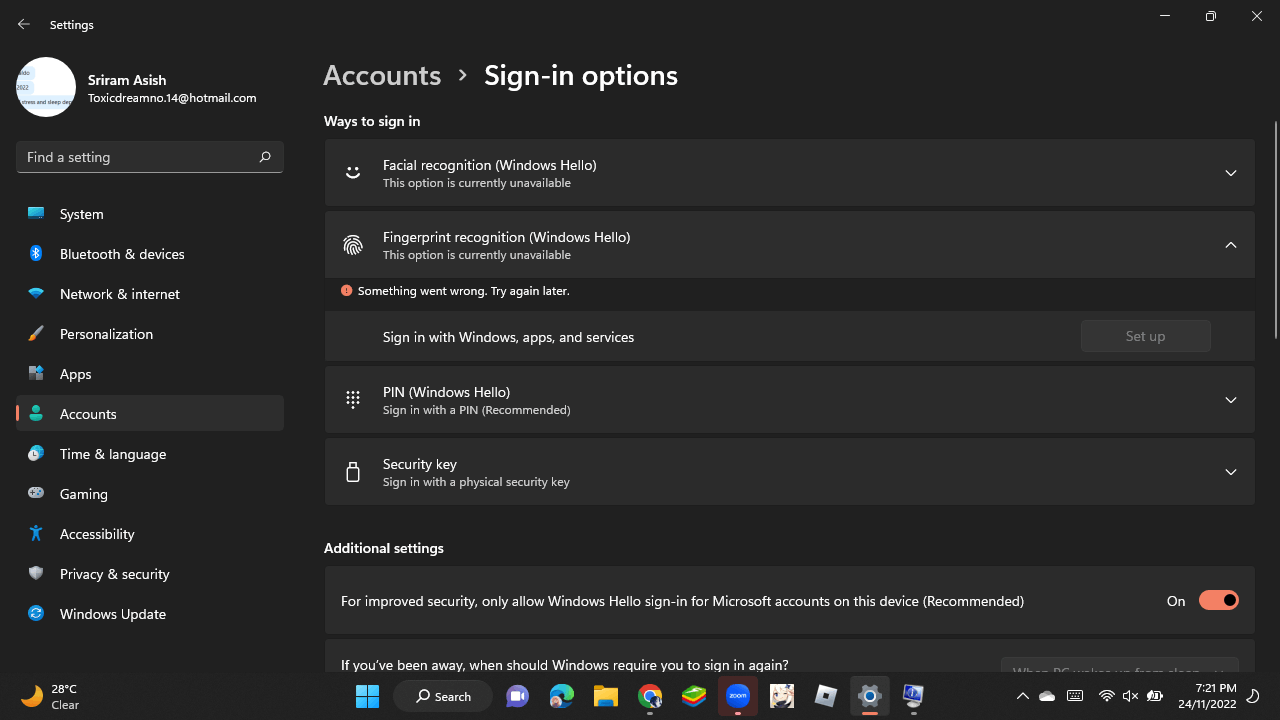

    Idk What happened but ive gotten the same problem and Im unable to fix it up
    it said to sign in to windows, apps, and services. but when i click on set up it wouldn't work at all...
