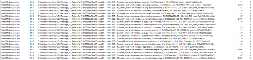

    The list of programs without proper documentation is endless. WaasMedic is just one. It showed up listed14 times in Task Manager in one moment in time. compattelrunner is another. I was able to find a program to uninstall some things, like Edge. But, for the rest, who knows if it is actually part of Windows or not?
