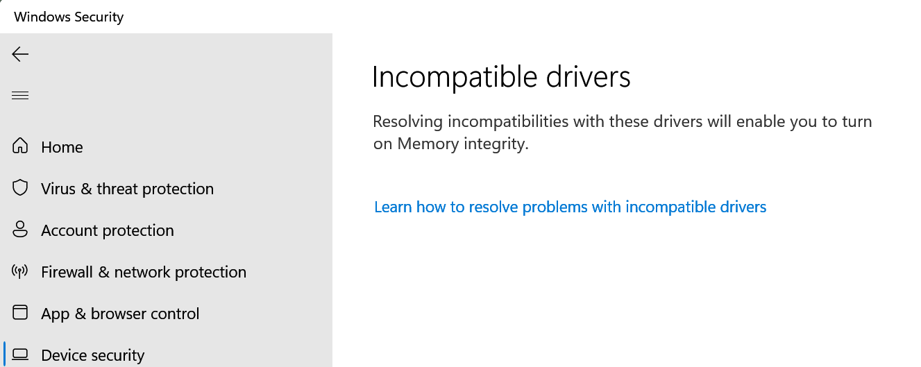

In new windows 11 up to date as of writing this. Core isolation memory integrity does not work and will not turn on. Every time I scan for incompatible drivers, none are listed. Checked the windows update, the system is up to date, and no errors in device drivers were found. All drivers appear up to date. BIOS most recent available (the same driver that was installed prior to this error occurring. None of the threads seem to address this, only ones where the driver is known. The DG readiness tool is not user-friendly for everyday users. Need a solution that can be done at home without having to be an IT guru or MSCE certified. It will not let me upload the screenshot or picture, keep getting errors in that as well.

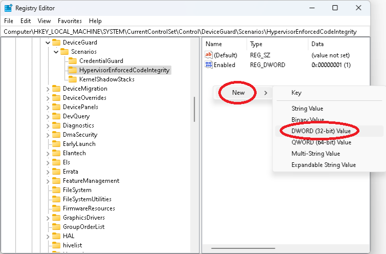

    With "HypervisorEnforcedCodeIntegrity" selected on the left side, right-click in the open area to the right to get a context menu. It will only give one option - "New".
    Select New. This will give you a new list. Select DWORD.
    This will give you a new entry. Name it "Enabled".

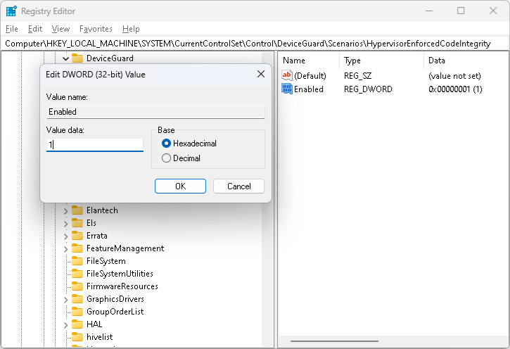

    Double-click on the new entry to open an Edit window. Enter a Value of 1, and click OK.
    These changes to the Registry take effect immediately - you don't have to "save" anything. But you will have to reboot your computer for this particular change to do anything.

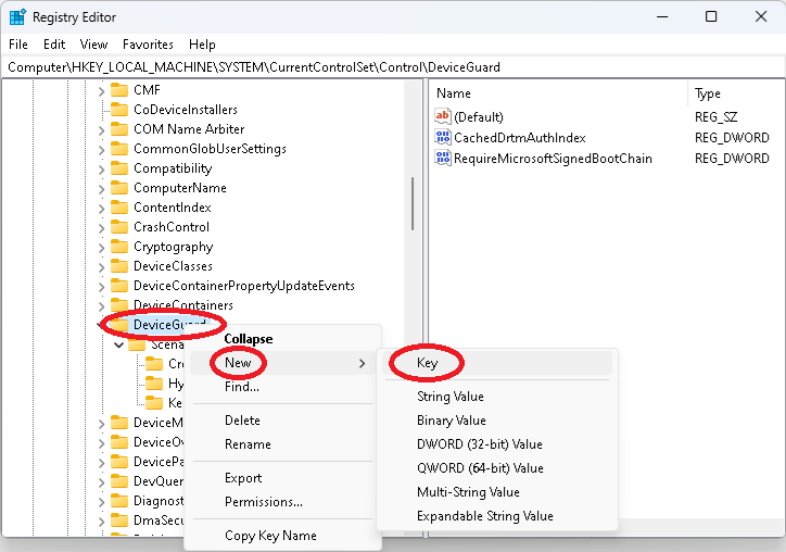

    2024-01-22T22:44:46+00:00
    You may just need to click an arrow in front of DeviceGuard to show subfolders / subkeys:
    See if it's really there. The subkeys are listed on the left side, not the right side - only the values are on the right side.
    If you really don't have a Scenarios folder, you'll need to create it. Right-click on DeviceGuard, select New and Key,
    Then type the new Key name:
    Then create the HypervisorEnforcedCodeIntegrity key inside that:
    Then create the Enabled value inside that:
    See if that helps.

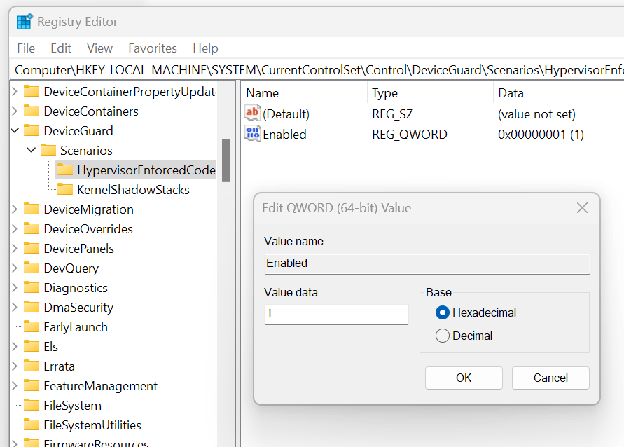

    2024-01-05T20:39:23+00:00
    In your screenshot, we can't see the full key name, so I'm taking your word for having it spelled correctly.
    The Type needs to be REG_DWORD rather than REG_QWORD.
    And yes, there can be other reasons why it doesn't work for you. It'd be nice if MS still made stuff that operated in a simple and straight-forward manner with clear and specific error messages.

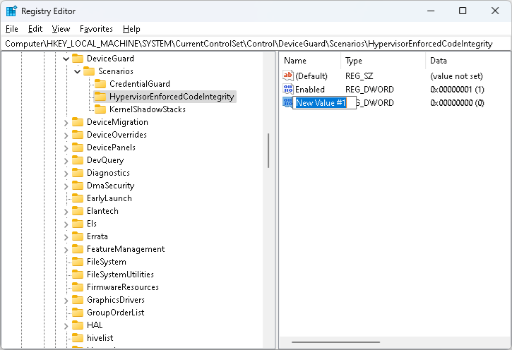

    2024-01-05T20:07:24+00:00
    You mean like so? Yeah, still no dice. (So maybe it's not working for everyone?)
