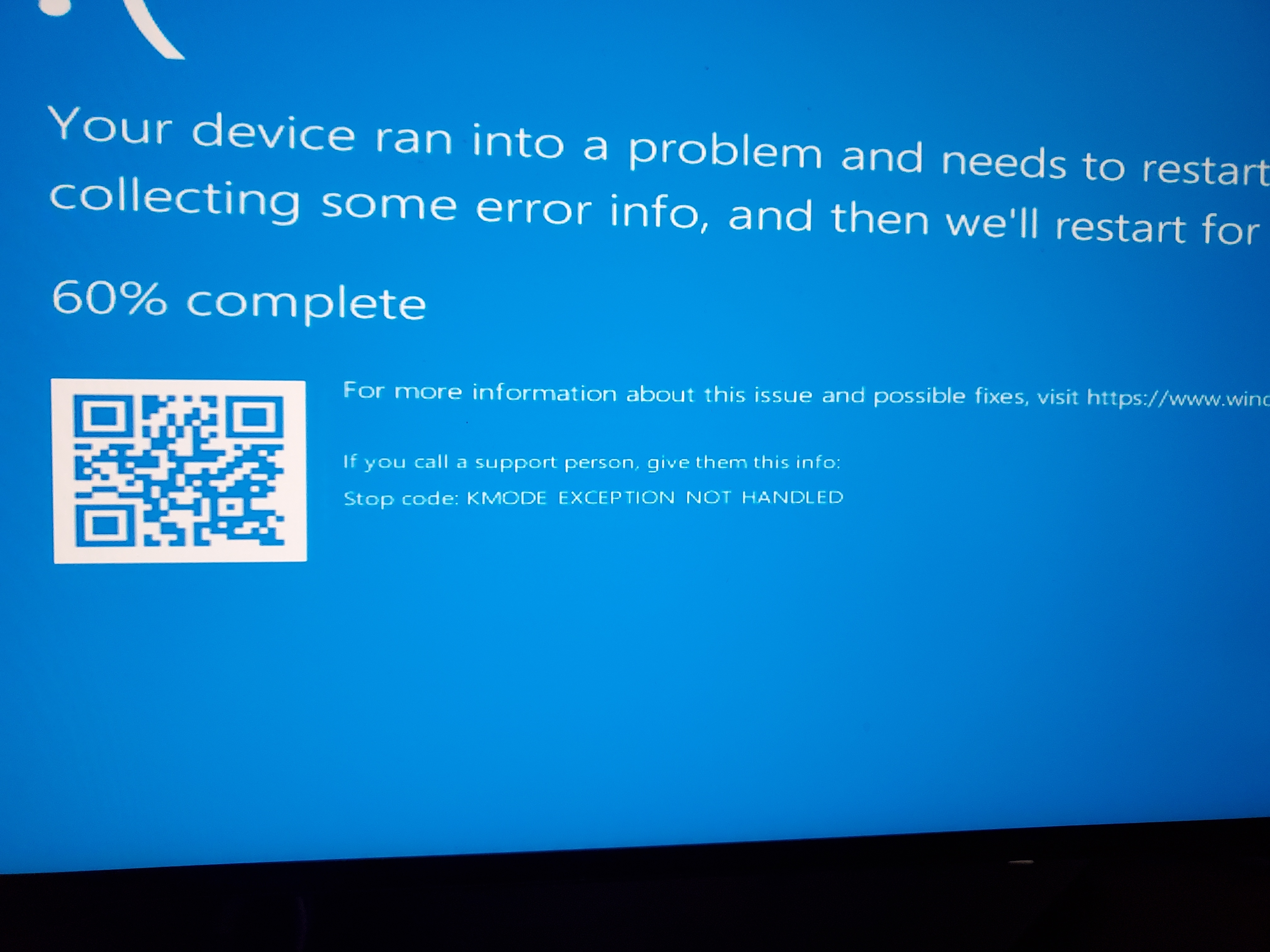

I am trying to update windows to 22h2 in an attempt to troubleshoot another issue i am having (games crashing when booting up dx12 with shaders with "out of video memory" error, same games work on dx11 though) and i have tried multiple times to update to 22h2 but it continuously fails. Windows will download the update, restart, install the update up to 25% and crash with blue screen showing an error with NTFS.sys i believe. So maybe the drive is corrupted by i've do so much to try to fix that.

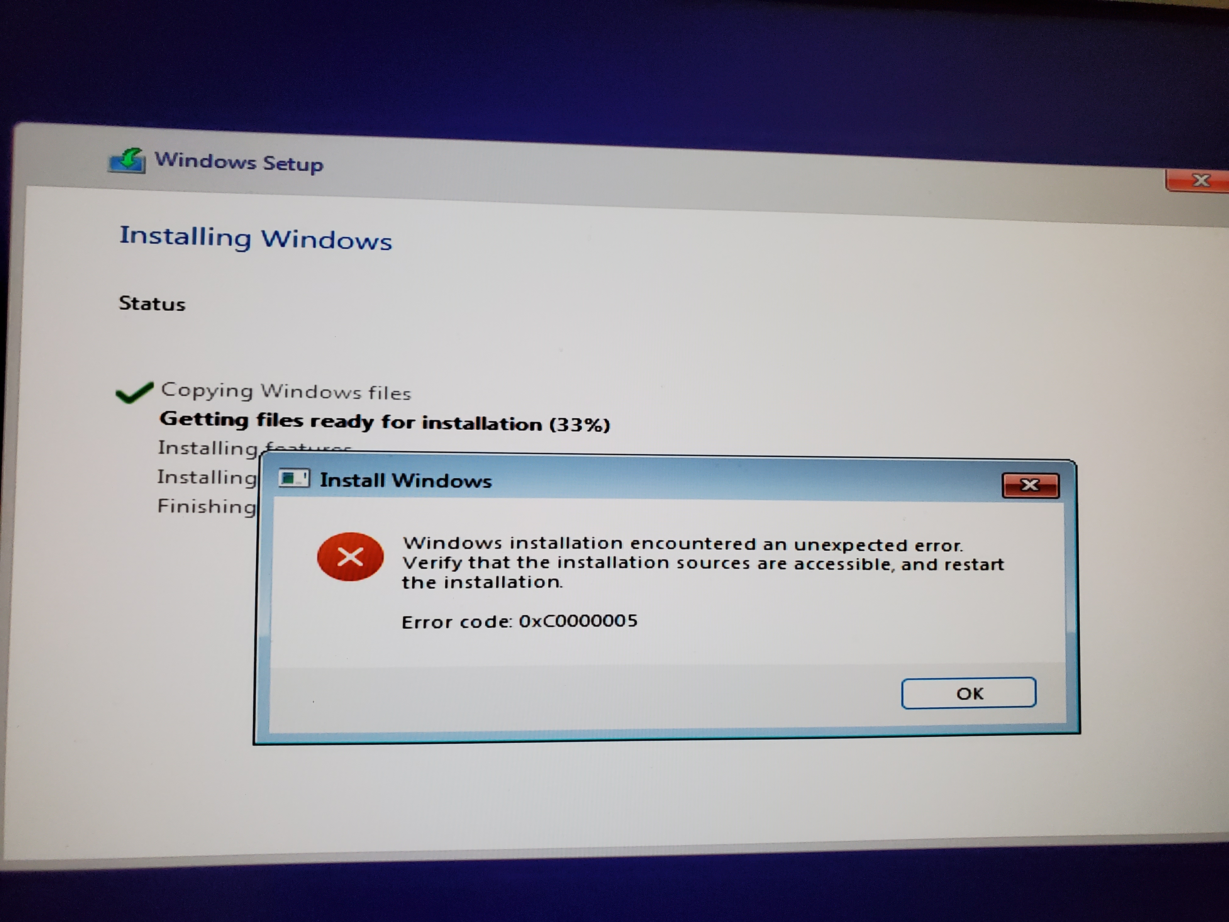

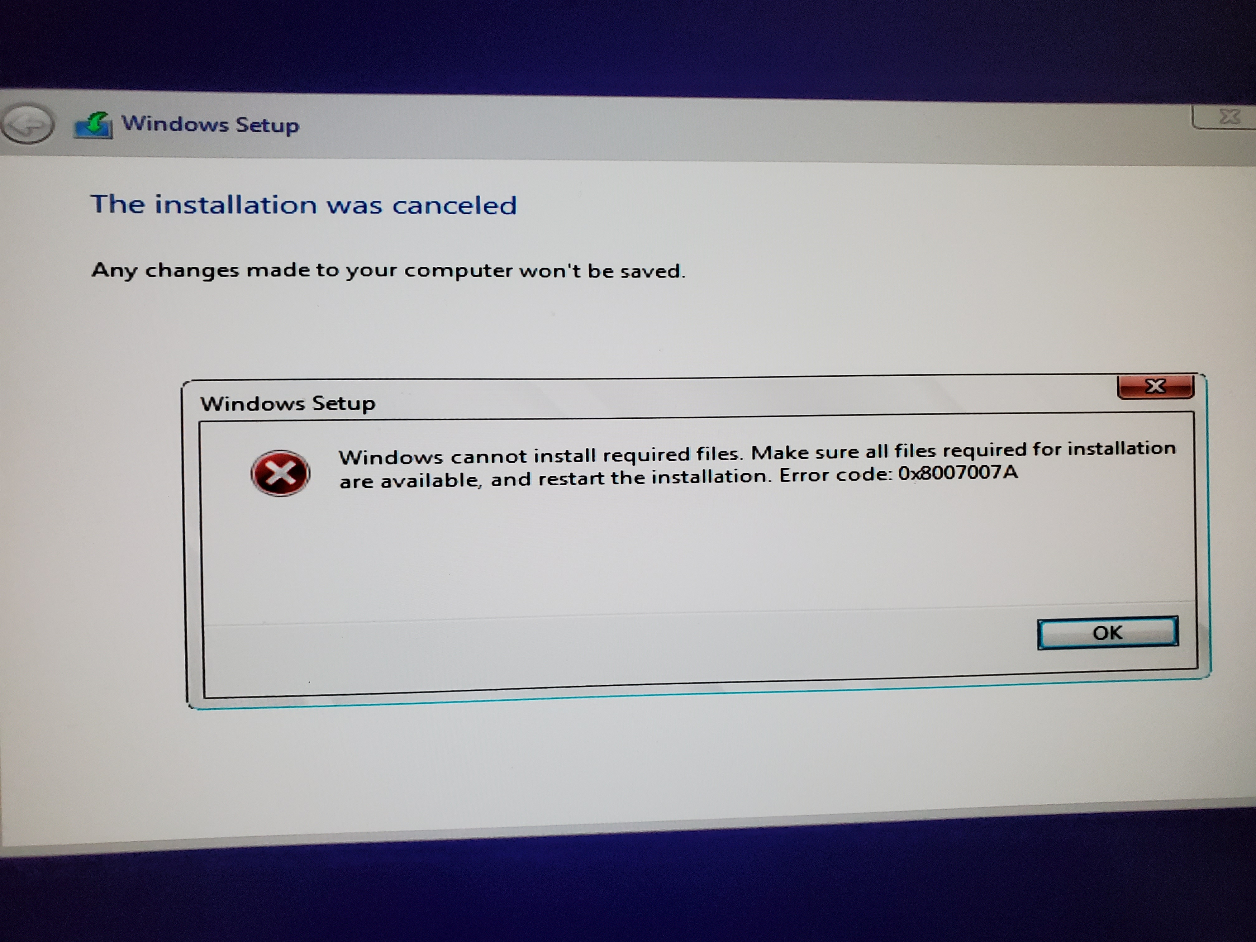

    I just flashed the bios to have the latest OS and I wanted to reinstall windows again but I keep getting this error in installation
    So I remade the installation tool 2 more times, one with win 10 and 11 and keep getting that error, along with these:

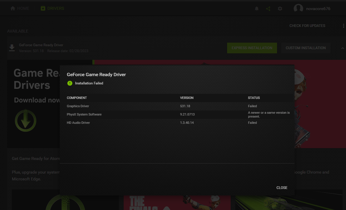

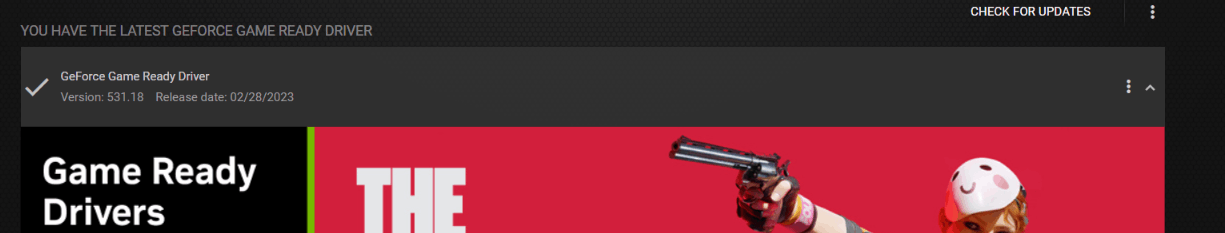

    2023-03-01T03:26:01+00:00
    yes, most of the games are online.
    Thats the first time ive seen the fsvdk thing so i believe thats not related.
    however, there are new graphics drivers that came out today and i tried to install them, and of course, they fail initially on the i9/asus system:
    but the i5/msi system i just built, no issues installing it:
