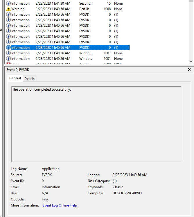

    i am not sure what it is but they all say the same thing below:
    2023-02-28T21:26:01+00:00
    What is the FVSDK? Some type of development kit for one of the games. I don't see it on my Callisto system.

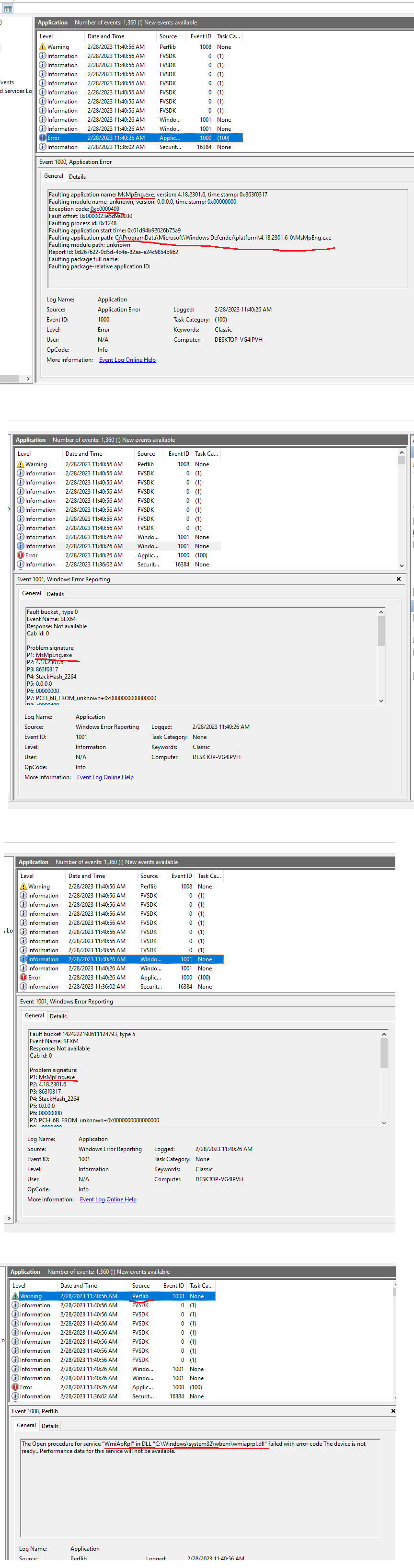

    I am going to post the event viewer which shows the events before and after the game crashes. The most common factor i see with the crashes are files concerning .dll is always involved and sometimes i see windows defender show up as well. I tried turning off the antivirus and it does not fix the issue. I feel like there is something cached in the motherboard or somehow, the processor, which is not allowing me to have the complete .dll library.
    I have tried to see if i could transfer the Kernelbase.dll from another computer but the files on this computer do not allow me to interfere as if i am not the admin and no matter what i do, i cant get privileges to change that.
    .dll files i feel are the culprit and i dont know how to restore it and i am honestly surprised its doing this on a brand new drive i just bought to test this out. This is again, telling me this has to do with either the motherboard or the processor. The gpu has nothing to do with it hardware-wise because i've tried 3 gpus, and the 4090 which was the original card in the system is working fine with no issues on my i5 13600k system i just built. Also, i've tried the other pcie lane for the gpu which did not help at all either.
    Here is the callisto results in event viewer
