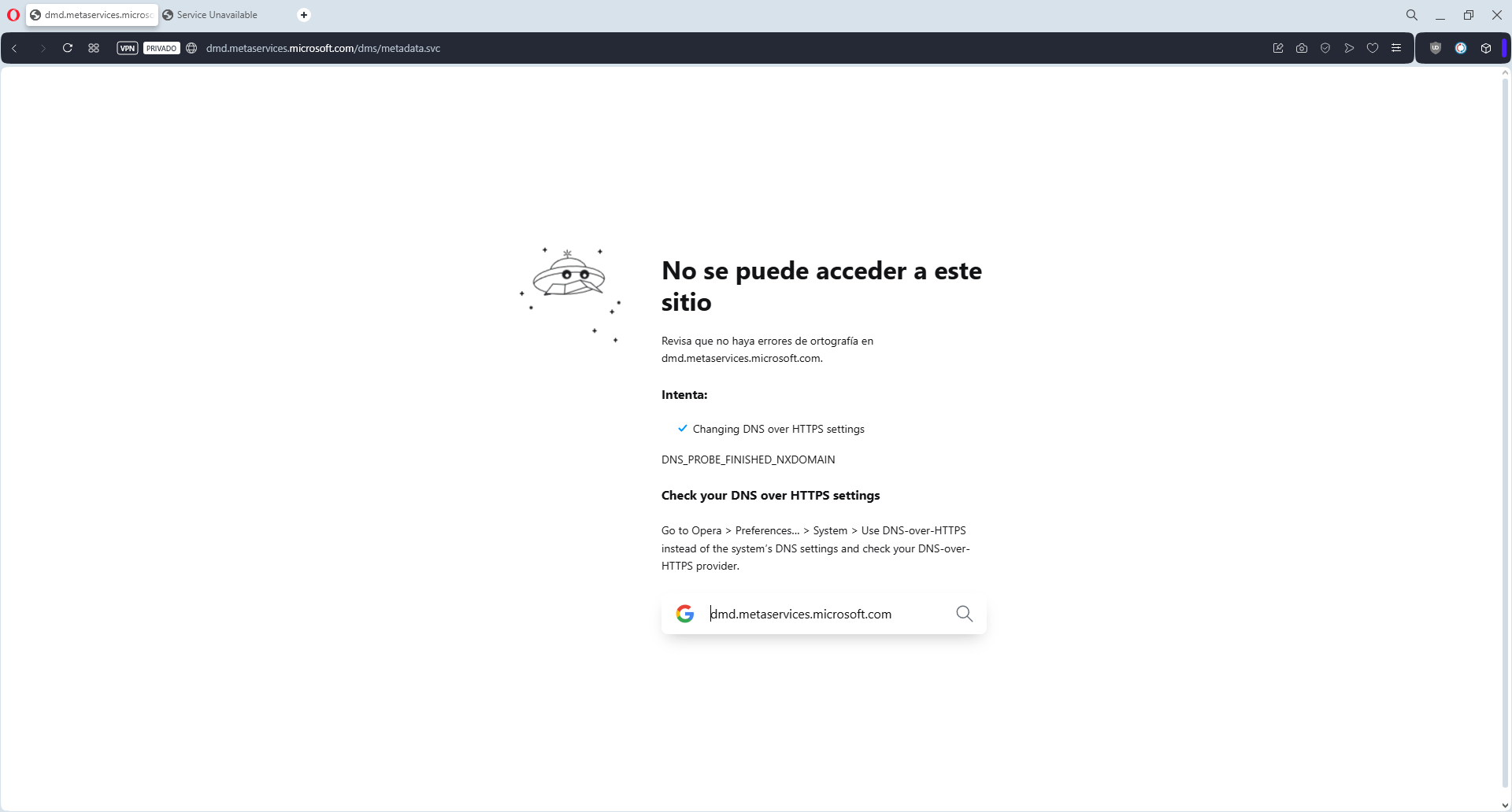

I got to looking at the registry for devicemedadataserviceURL.  I went to that URL (go.microsoft.com/fwlink/?linkid=252669&clcid=0x409) and got redirected  as site not available to  dmd.metaservices.microsoft.com where I pressed continue and got a 505 Bad Gateway error.

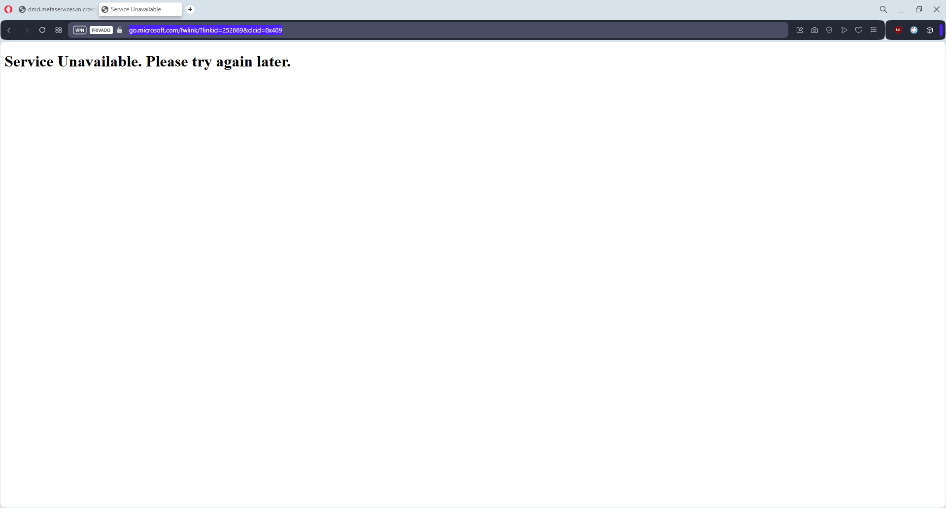

    For a week now, as of the date I am writing this comment, the connection to the drivers' metadata has been failing as indicated in the error.
    The URL go.microsoft.com/fwlink/?linkid=252669&clcid=0x409
    indicates the error
    "Service Unavailable. Please try again later."
    And if you try to access directly the URL that is supposed to redirect, it simply denies access as if the server were not running.

    But they have already fixed it - with another domain that does not resolve. 🤣🤡
    https://www.bleepingcomputer.com/news/microsoft/microsoft-says-it-fixed-a-windows-metadata-server-issue-thats-still-broken/
    The good thing is that you can now have error 201 instead of 131 instead. Excellent. 🤡🤡🤡
