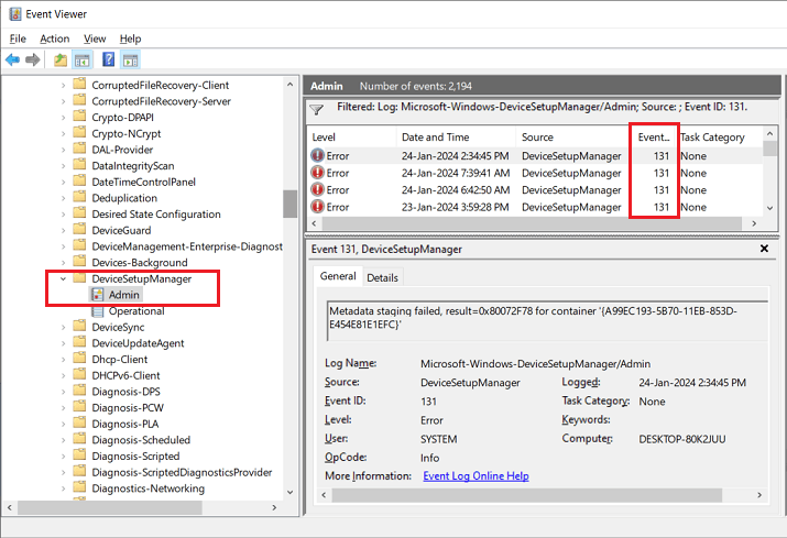

I did KB 890830, KB5032339, KB5032189 and KB4023057 today and on reboot after updating I started getting many of the event id 131 Device Setup Manager Metadata staging failed.  I would get the code 131 when plugging in my backup USB external.  Even when using USB thumb drive- this never happen prior to today's update.  Also, lots of the Event ID on boot. Never had these prior to the update. I am on WIndows 10 PRo, 22H2, OS Build 19045.3693, Dell OPtiplex 64 bit, 12GB memory and 500GB disk.

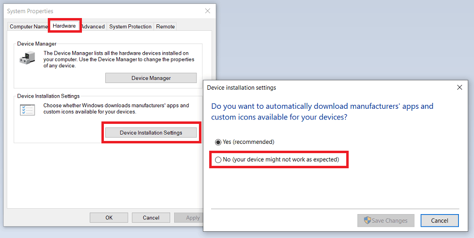

I should add going to control Panel, search for Device Installation, select change device installation setting to NO- does fix the error.  Tested, reboot or adding external drive no longer gets the 131 error.  Now is this a good idea, I don't know, I am not that up on computers anymore.  I retired in 2003 after 38 years as system software tech on mainframes.  Was certified also for Microsoft, but a lot changed since then and I really don't attempt to keep up.

    If you aren't sure, open your Event Viewer and browse to Application and Service Logs | Microsoft | Windows | DeviceSetupManager | Admin to see if these DeviceSetupManager Event ID 131 errors are being logged there.
    If you do have these Event ID 131 errors then use the workaround posted <here> on 23-Dec-2023 on page 1 of this thread (i.e., change the Device Installation Settings to "No" in your Advanced System Settings) and then check your Event Viewer again to confirm this has stopped the Event ID 131 errors.
