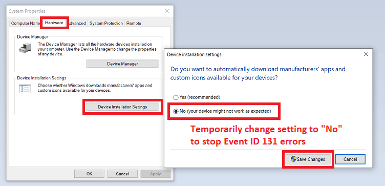

I should add going to control Panel, search for Device Installation, select change device installation setting to NO- does fix the error.  Tested, reboot or adding external drive no longer gets the 131 error.  Now is this a good idea, I don't know, I am not that up on computers anymore.  I retired in 2003 after 38 years as system software tech on mainframes.  Was certified also for Microsoft, but a lot changed since then and I really don't attempt to keep up.

    If you read my 23-Dec-202 post <here> on page 1 of this topic I said "These DeviceSetupManager Event ID 131 errors in my Event Viewer are annoying but they don't seem to be causing any obvious problems on my Win 10 laptop". I didn't claim that was the case for everyone.
    Try the workaround suggested in that post (i.e., change the Device Installation Settings in your Advanced System Settings to "No" and re-boot ***) . If this stops your Event ID 131 errors and you continue to have issues with your LG Webos TV then the Event ID 131 errors are not the root cause of your problem.
