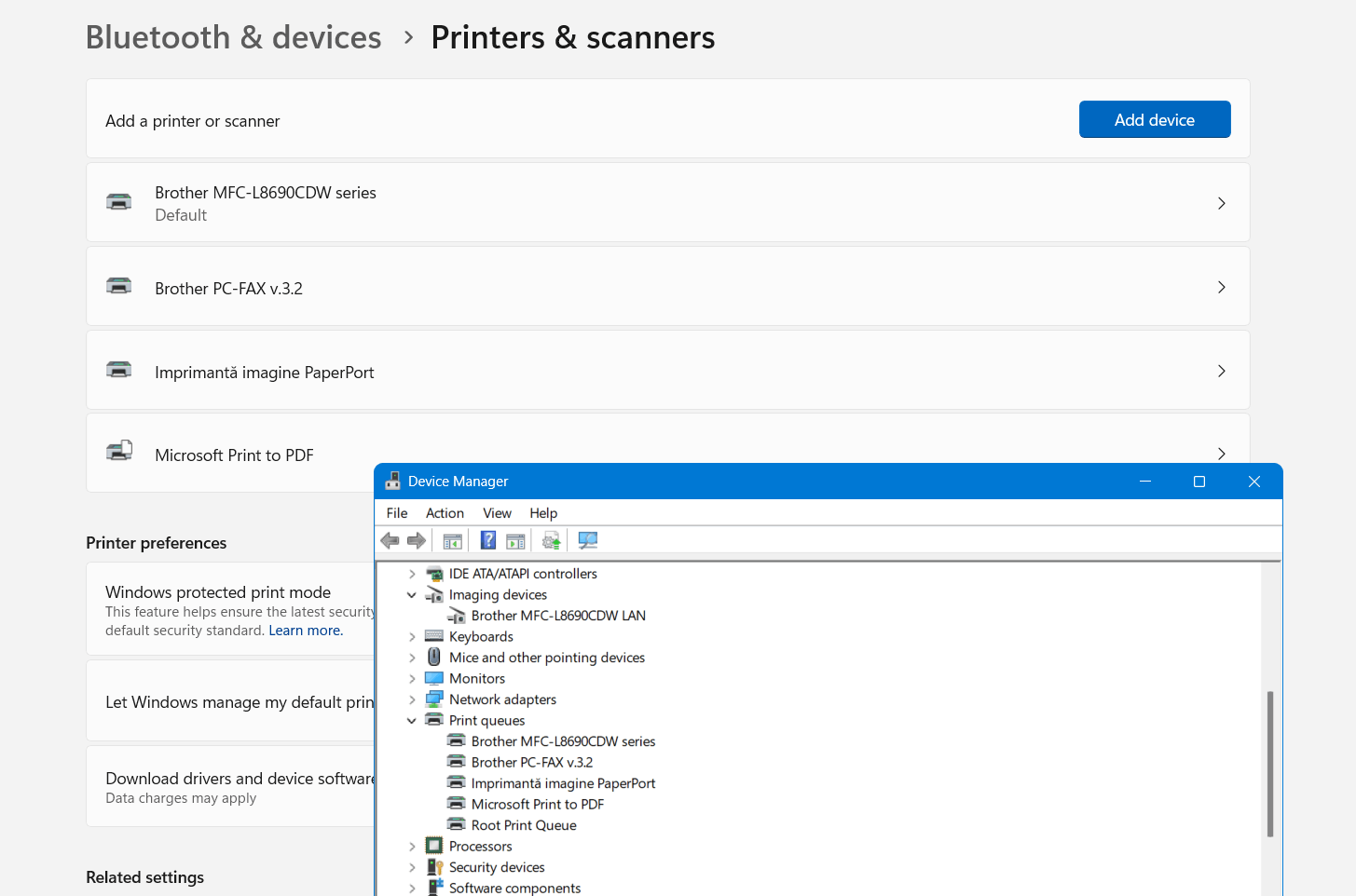

    I use ControlCenter4. I don't agree with Brother iPrint. I have installed all MS updates, uninstalled and installed "Brother Full Driver & Software Package" (https://www.brother.co.uk/support/mfcl8690cdw/downloads), scanned the laptop for corrupt files, everything is fine. I can't scan from the device to the laptop.....
    My scanner doesn't appear in "Printers & Scanners". Only the printer. Is it the same for you?

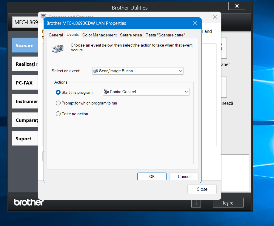

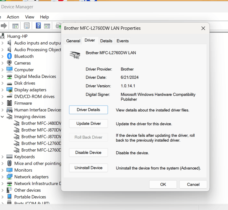

    Oliviu,
    Did you define the action under the event in Scanner and Cameras profile?
    Also check installed driver under Device Manager is Brother driver not MS wsd driver.

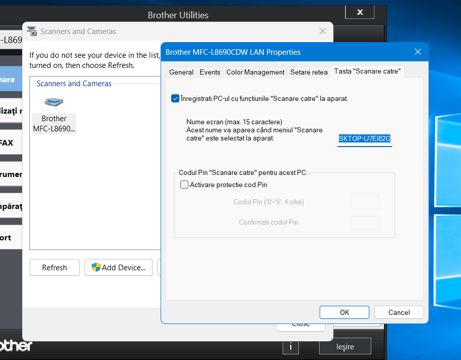

    2025-04-10T12:39:41+00:00
    In order to scan from device to computer, you need to register and define your computer with the "Scan to" function at Properties/Scanners and cameras/Scanner settings under printer settings. When you scan to computer from the device, the computer will launch the scan software to receive the file.

    I ran all the CheckHealth, ScanHealth and RestoreHealth check commands. I also ran System File Checker, uninstalled, checked with cccleaner to make sure nothing remains from the old installation, everything is fine with the operating system. The scanner (MFC-L8690CDW) does not connect to the laptop when I want to scan from the device, to the laptop. From the laptop I can scan and print without problems.
