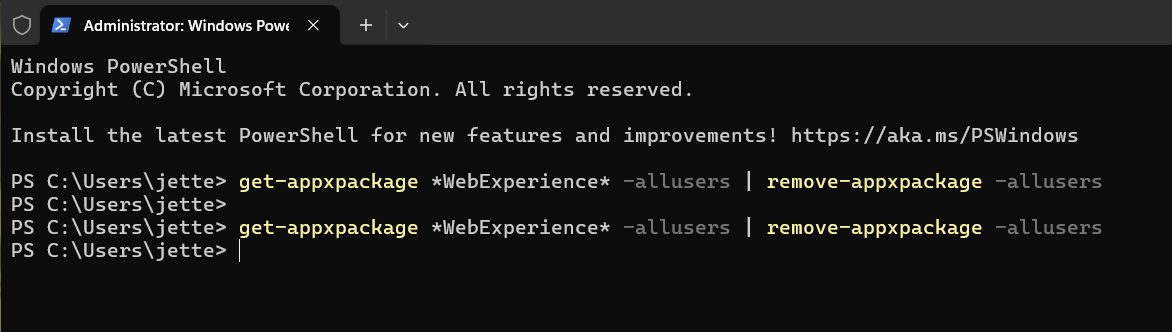

    On my system, when I press Win + W, it launches widgets.exe instead of widgetboard.exe.
    Please open *admin* PowerShell and run:
    get-appxpackage *WebExperience* -allusers | remove-appxpackage -allusers
    (Note: This is slightly different from the command you ran before. This one removes the WebExperience package folder completely.
    Once done, restart Windows.
    Visit this link:
    https://apps.microsoft.com/store/detail/windows...
    Reinstall Windows Web Experience Pack.

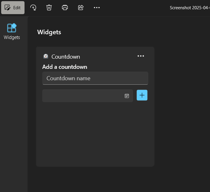

    Hi Ramesh,
    I took down procmon and have created a logfile as to your instructions.
    My current problem is to get uploaded to my File Manager.
    When I have done this I will send you a full https-link for you to download the zipfile.
    When I activated the Widget Board no error message came up. The Widget Board part appeared but the Microsoft Start Feed section is nowhere to find.
    Here is a screenshot of the current situation:
    It is getting more and more weird...
    I will get the Progmon Log file uploaded so I can send you the link.
