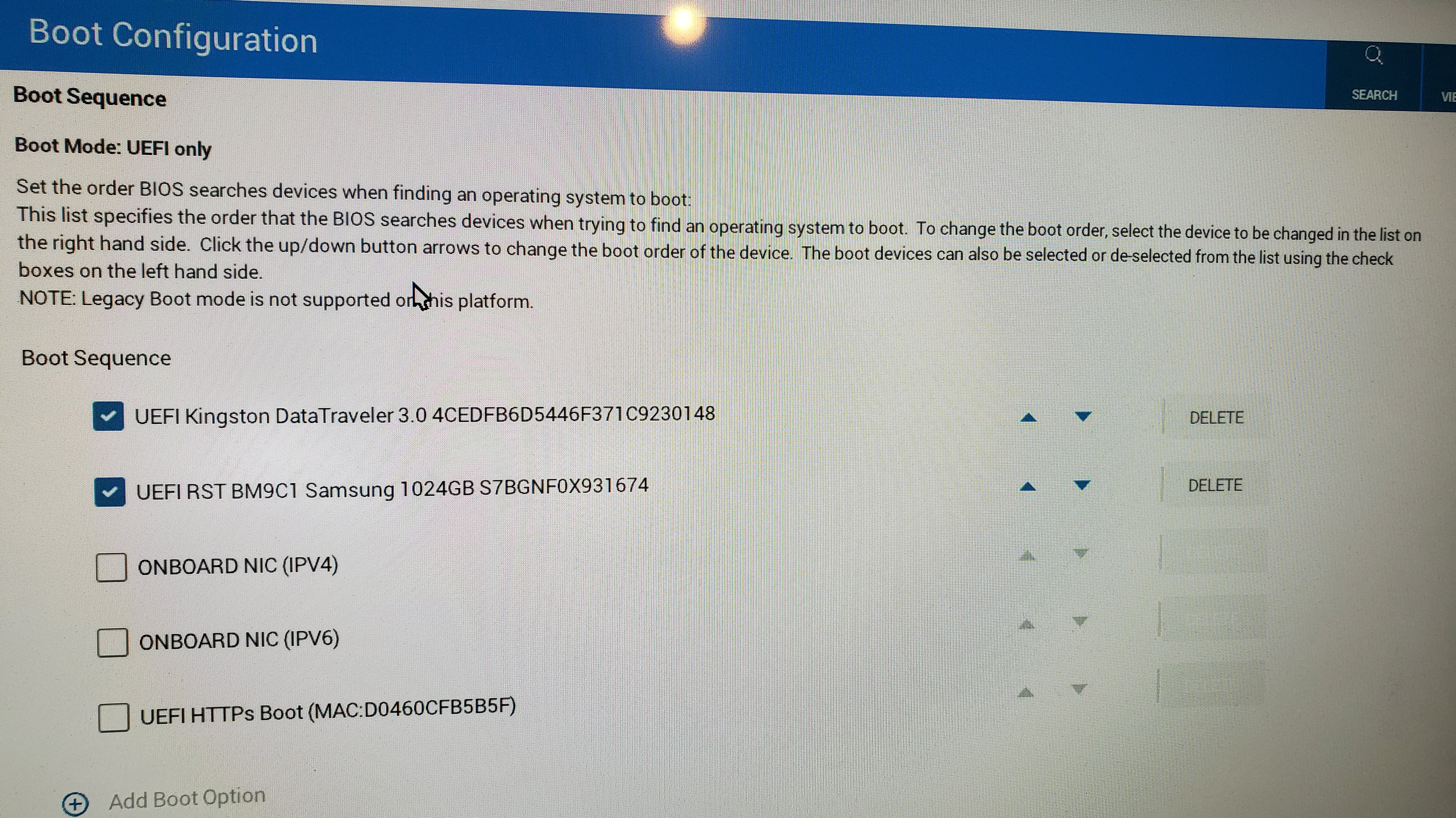

    Boot Configeration Photo 1 of 3
  2. Manoel Barros 22,035 Reputation points Independent Advisor
    2025-04-27T02:32:33+00:00
    Access the BIOS and send me photos of the Boot, Advanced and Security tabs.

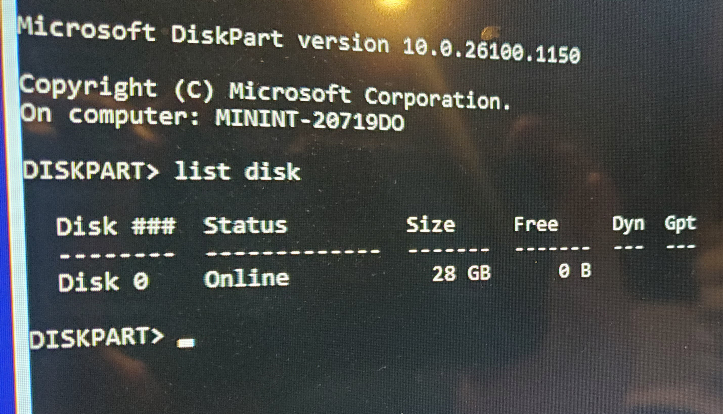

    2025-04-27T02:24:33+00:00
    This is what it shows. Looks like only the flash drive.
  4. Manoel Barros 22,035 Reputation points Independent Advisor
    2025-04-27T02:17:17+00:00
    You need to type the command below first:
    diskpart
    lis disk
