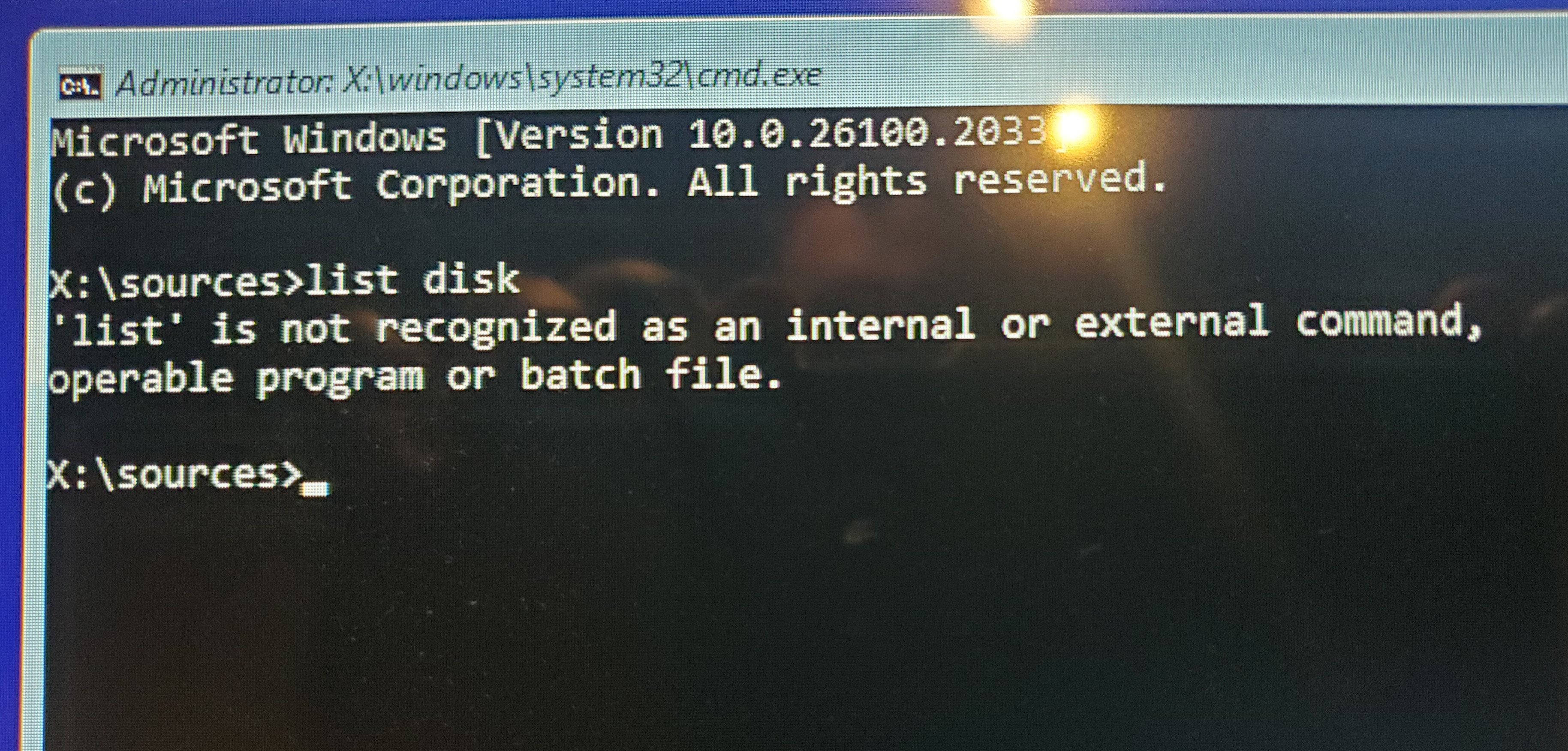

    2025-04-27T02:00:19+00:00
    Says it's not a valid command.
  2. Manoel Barros 22,035 Reputation points Independent Advisor
    2025-04-27T01:52:38+00:00
    The shortcut SHIFT + F10 should open a Terminal. When you start in the Windows Installation Menu, press this shortcut and see if the Command Terminal appears.
    2025-04-27T01:49:19+00:00
    I went back into BIOS and did it again. All were checked again. I only kept the flash drive and hard drive checked with the flash drive at the top, hit Apply Changes and then Exit. Same comes up with the hard drive not showing up on the "Select location to install Windows 11." I hit Shift F10 on that screen and nothing happens. Am I supposed to hit Shift F10 at a different point, maybe when the computer is booting up?
  4. Manoel Barros 22,035 Reputation points Independent Advisor
    2025-04-27T01:40:12+00:00
    Just to confirm, did you apply the changes and exit?
    See if the disk appears in diskpart, in the "Select location to install Windows 11" menu.
    1. Press SHIFT + F10.
    2. Enter the following command:
    list disk
    1. See if the 1TB disk appears.
