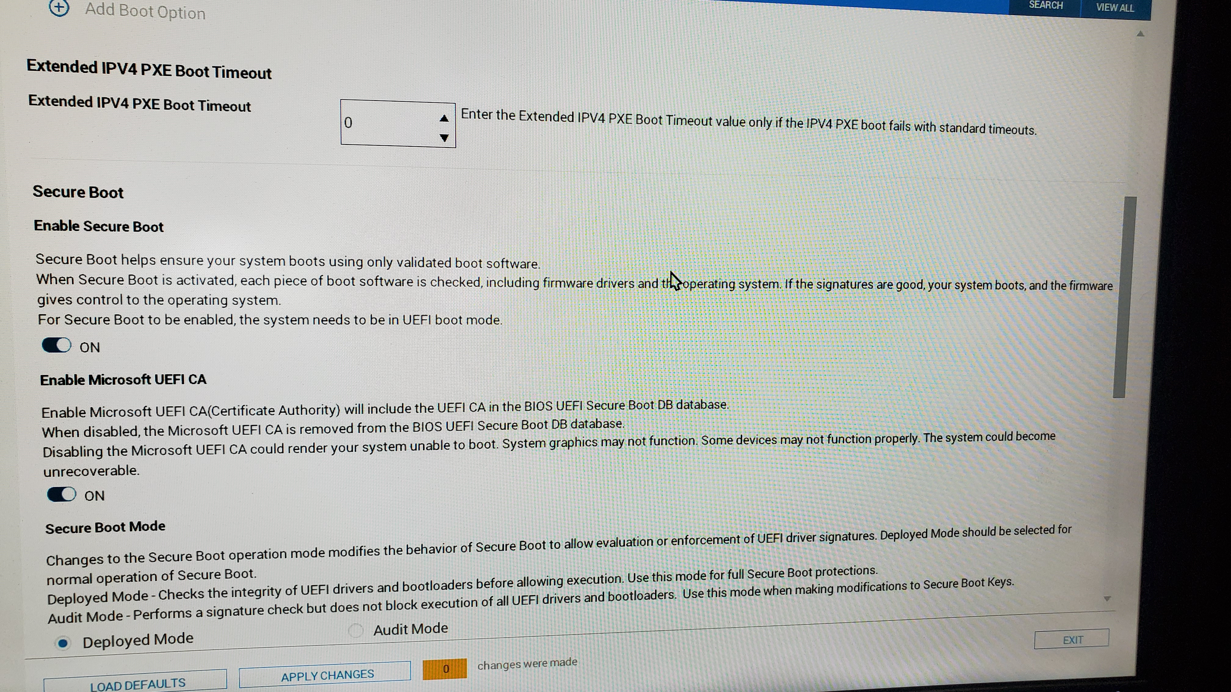

  1. Manoel Barros 22,030 Reputation points Independent Advisor
    2025-04-27T03:00:25+00:00
    I've had this happen on a Dell computer.
    Disable Secure Boot > Apply Changes > Save and Exit > See if the Disk appears.

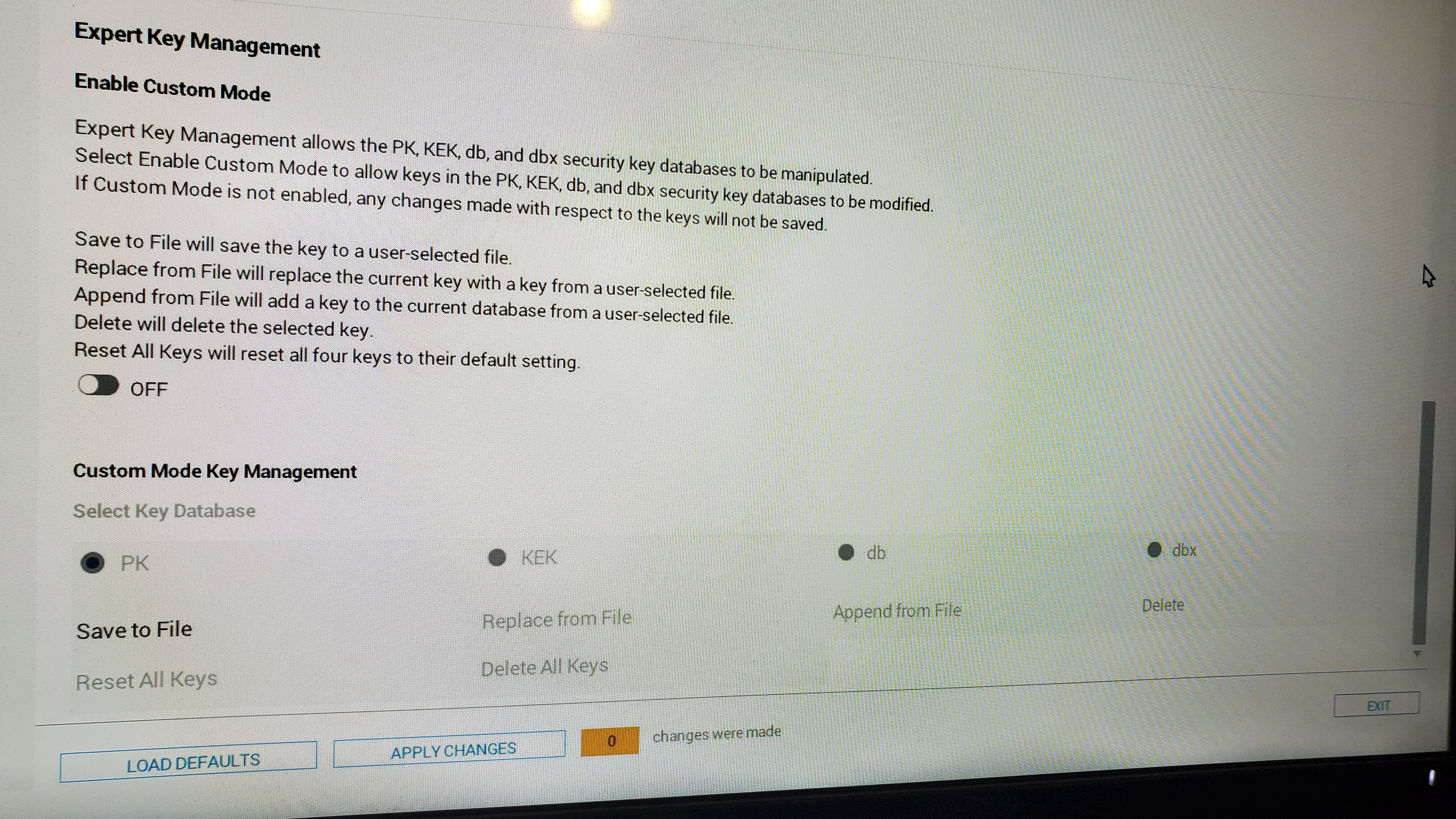

    2025-04-27T02:49:57+00:00
    Security Photo 1 of 4
    2025-04-27T02:46:03+00:00
    Boot Configeration Photo 3 of 3
    2025-04-27T02:45:06+00:00
    Boot Configeration Photo 2 of 3
