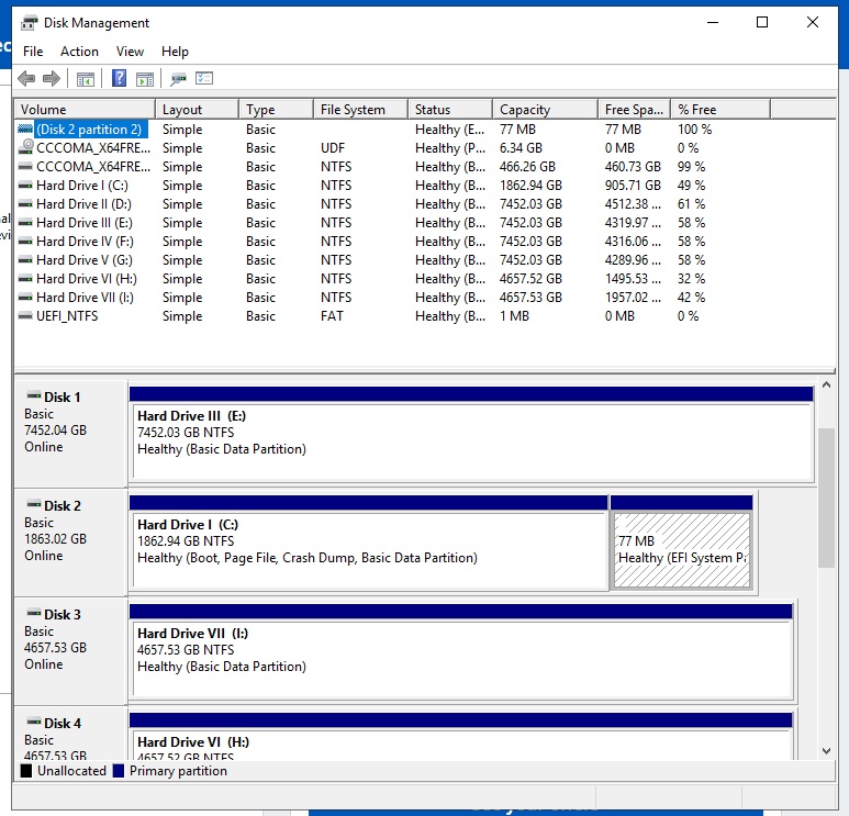

2025-06-20T10:10:58+00:00
Please run:
diskpart
select disk 2
list part
select part 2 -- This selects the EFI partition
del part override
create partition efi
format fs=fat32 quick
assign letter=Y
list vol
exit

    2025-06-20T05:09:52+00:00
    Failed C drive removed, SSD drive installed. I cloned C to the SSD. The SSD doesn't show any errors anywhere. The new SSD C drive does boot up and operate fine. When I try to upgrade to Windows 11, I still get the error message that Windows can't figure out if there's enough space.

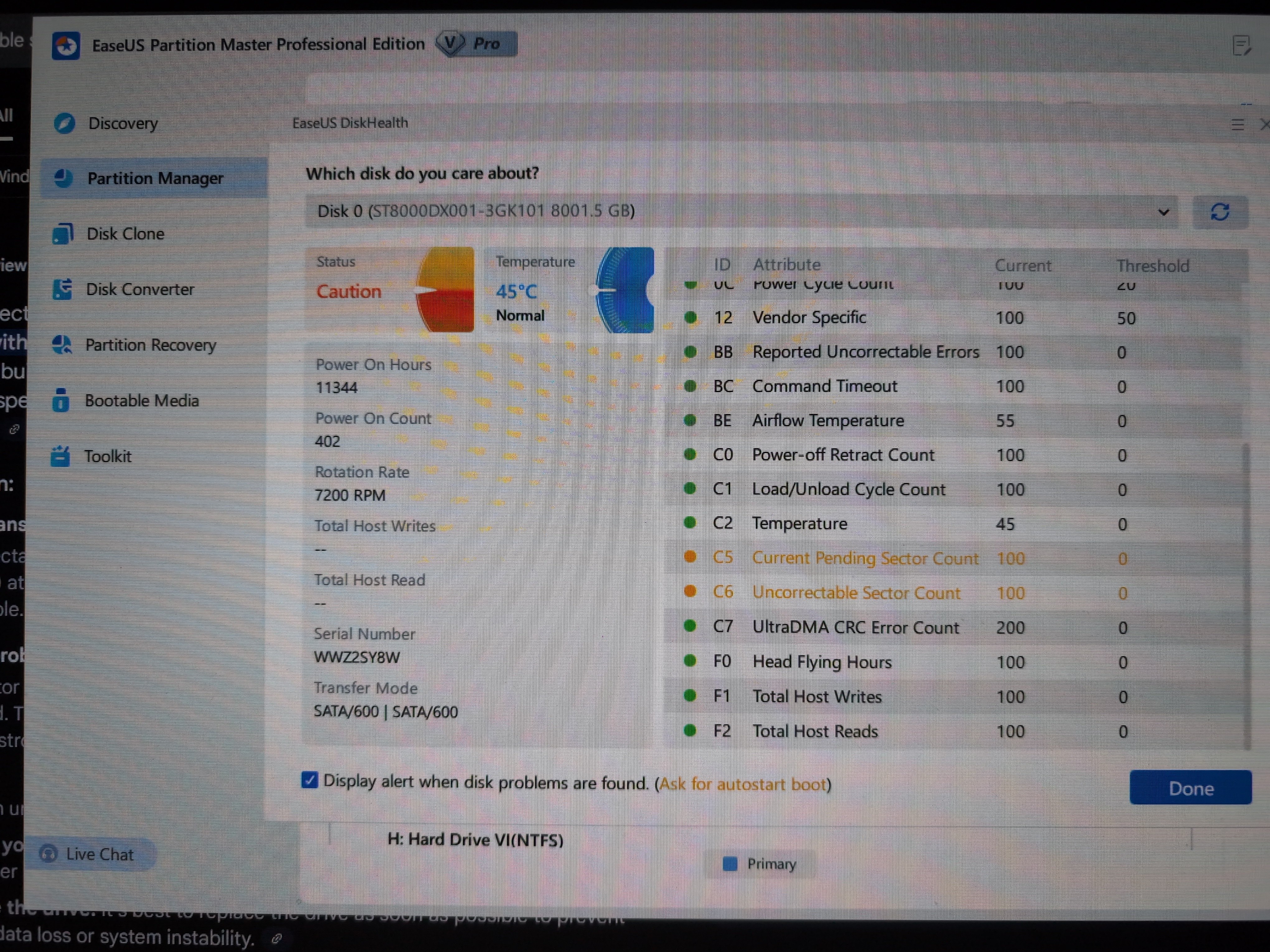

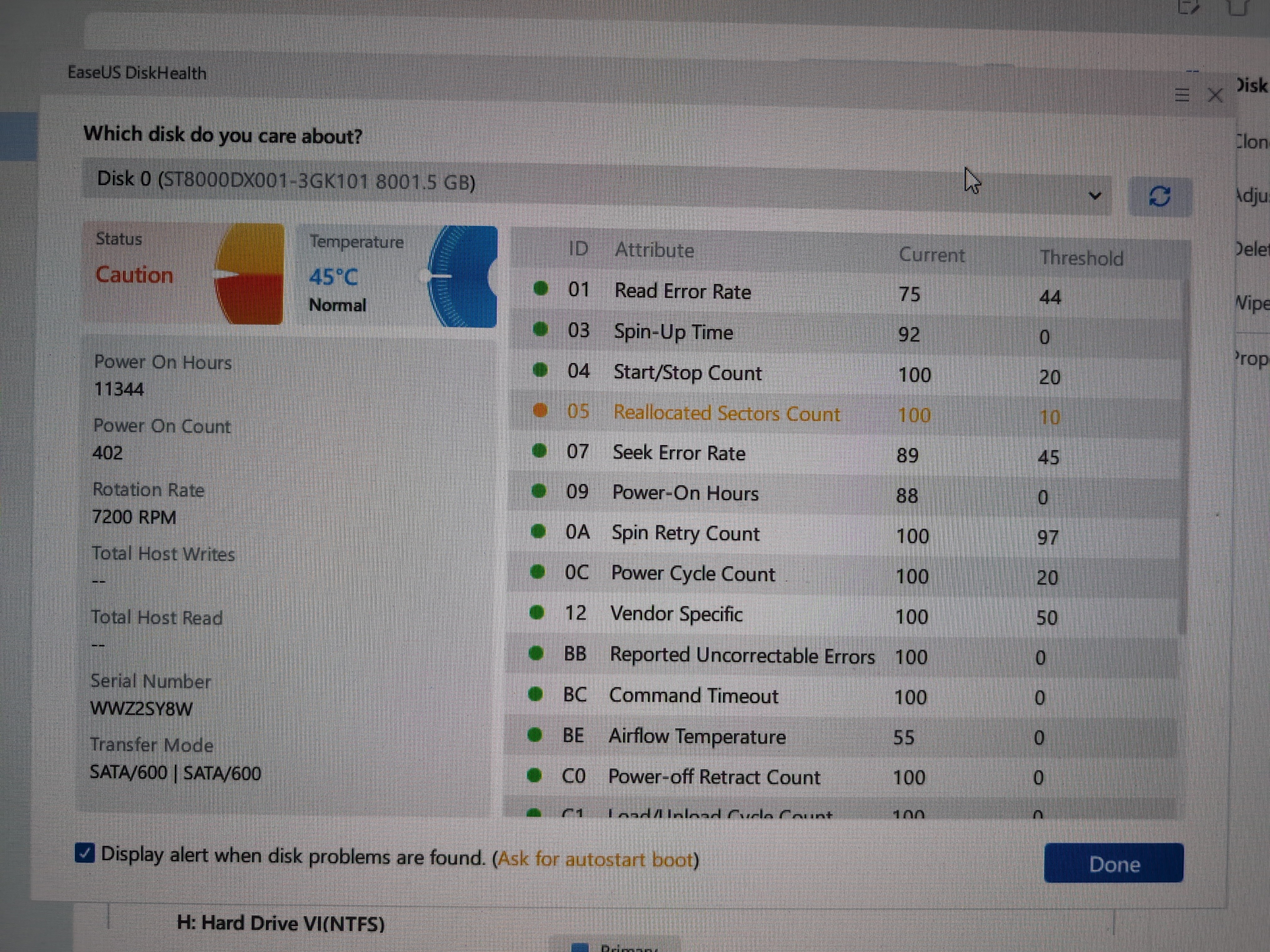

    2025-06-19T04:29:54+00:00
    I used EaseUS Partition Manager on the C drive and I noticed the "Caution" message regarding the C drive. These are the errors. The drive is failing. If I use the Clone/Migrate OS feature inside this app to clone to a different 8TB hard drive that I know is good based on what Partition Manager is currently showing as, will these errors matter in the clone process?
    Also, once on a good, working drive, do you think the Windows 11 upgrade will work without issue?
  4. Ramesh 181.9K Reputation points Volunteer Moderator
    2025-06-19T02:00:02+00:00
    No. The disk has gone bad, as you can see in the following image.
