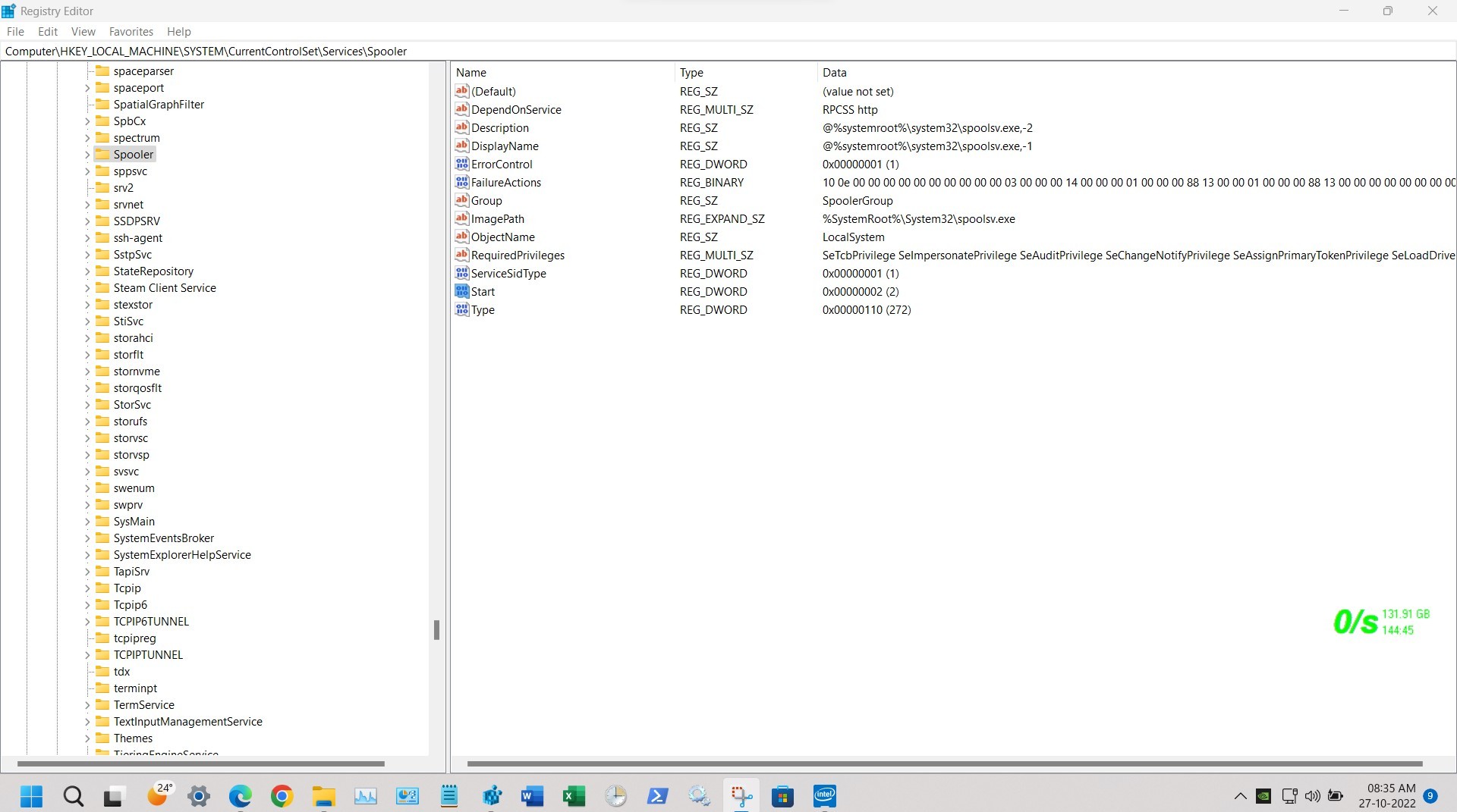

    method 2
    Boot windows into safe mode , open registry editor , then make startup type spooler services as automatic by changing the number to 2
