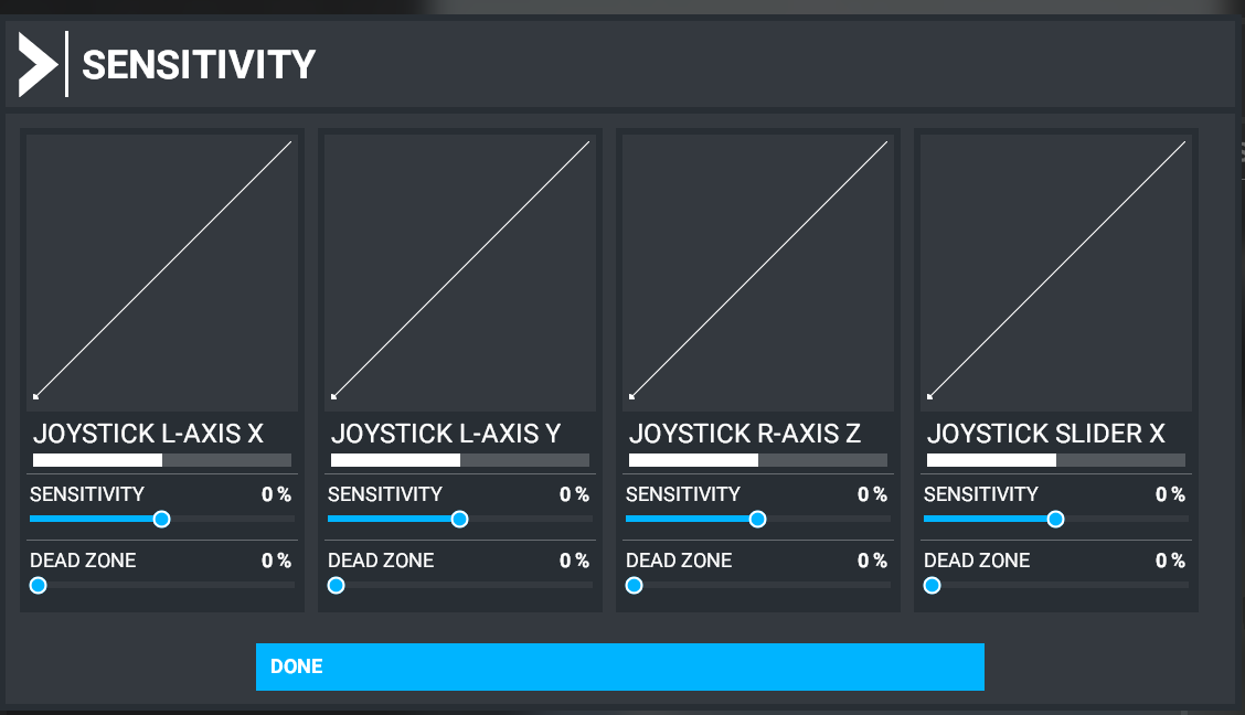

    The roll (ailerons) is smooth on mine. The game's response to the joystick's movement is pretty sensitive so I use a light touch.  I also have to be careful not to twist the joystick while I'm turning which is easy to do as that will cause the rudders to move. I did not adjust any of the sensitivity settings or dead zones.  Below is a screen shot of those settings.  When I move any of the axes they move smoothly on the diagonal line and each 'left / right', 'forward / back', 'twist left / twist right' moves the horizontal bar 1/2 way left or right from center which is also smooth.
    Note: Make sure your movements are tied to the correct axis setting.  I had to play with this for a while until I got it right as there are so many axis settings.  The ones I listed are the ones that are working for me.
