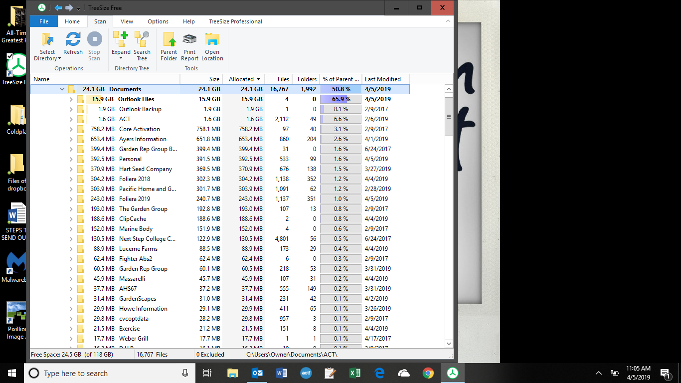

    2019-04-05T15:06:49+00:00
    Dave:  Not sure but it looks to be in the Outlook files.  You tell me what you think

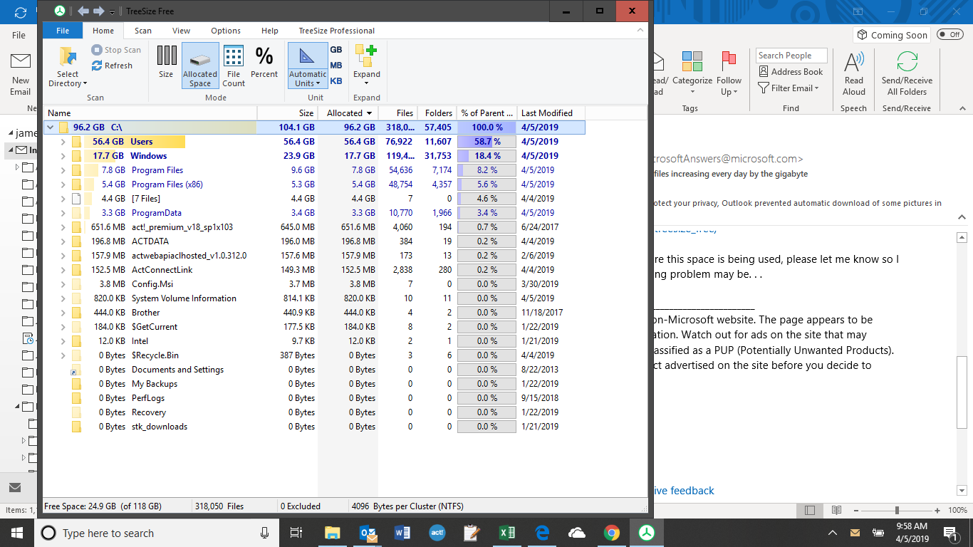

  2. DaveM121 936.1K Reputation points Independent Advisor
    2019-04-05T14:03:07+00:00
    Hi James
    Everything there looks very normal, with the exception of the users folder
    Expand that folder in TreeSize and check for any sub-folder that should not be taking up unexpected space . . .
    2019-04-05T14:01:05+00:00
    I did what you suggested and downloaded the software.  Shown here is the result
