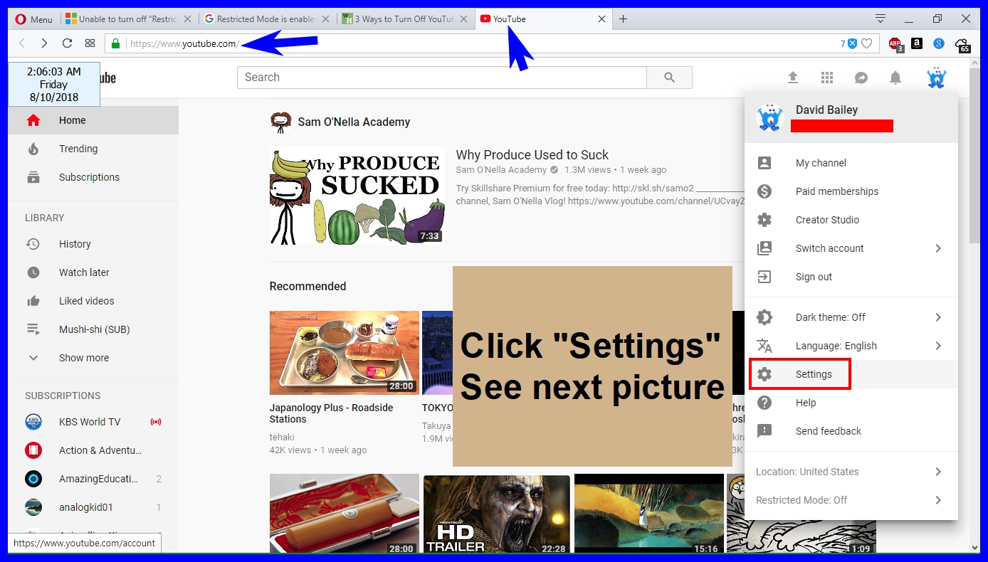

    Sign into Youtube.
    Click your icon at top right corner.
    See picture below---
