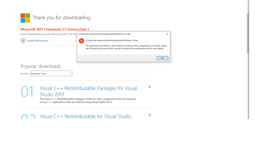

    2017-04-24T00:59:23+00:00
    hello,
     I am having a similar issue except almost every application I try to open gives me the side-by-side configuration error.  I've gone through all the steps you suggested but am still having the issue.  Please let me know what else I can do to address it.
    thank you
    Ian
    2017-04-18T13:23:03+00:00
    I tried this twice, but no success!
    Any additional advice?
    Leon
