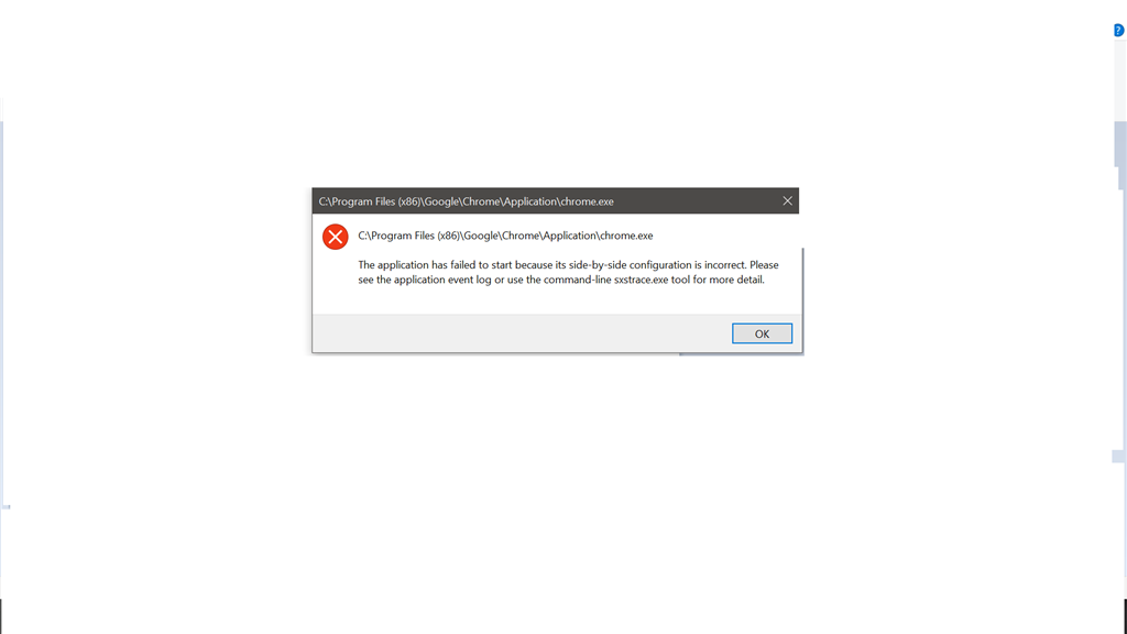

    2017-04-13T11:45:22+00:00
    image of what it comes up with when I press into my Chrome browser:

    I have tried both of your resolutions and both have been unsuccessful. Here is an image of what it comes up with when I press into my Chrome browser:
    Please help me with this issue, your help will be largely appreciated.
