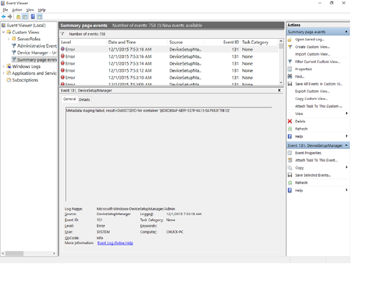

    I'm flabbergasted. That fix has always worked for me & continues to work. The problem it fixes comes & goes & has been doing so over years. It's a matter of MS's server getting slow. I'm thinking - looking at your Event Viewer - that your computer is itself a server. Maybe that puts a further stress on the situation so that neither URL will work.
    But I think Rusty-45 is correct that the devices do get serviced. It's just that you must have extra junk lines in Event Viewer. That is, unless - as I saw in one thread - you have Event Viewer simply not record the event. Can you find that?

    Yes, the metadata staging errors are a timing issue & nothing to get too excited about.. I stated this in my posts of May 26 & May 29. If you will check your device manager setup administration log you will probably see that each device is being properly serviced, etc. which is exactly the same info you were probably getting before the errors started. Once again remember, these actions are taking place within milliseconds of one another.

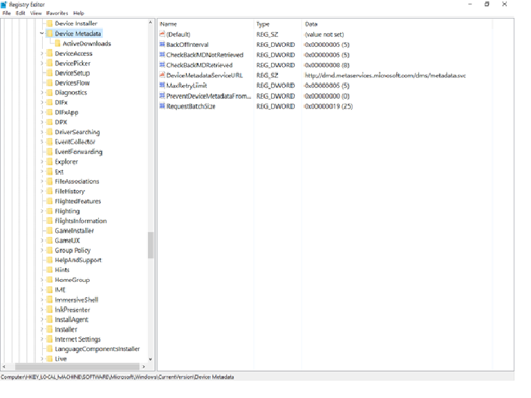

    As you can see I have change it, and still getting the errors:
    I found people on social TechNet with the same issues. One person has found it appears to be a timing issue to the url. Reading the posts, it looks to be, it started around May 6 2015.
    If it is indeed a timing issue, I wonder if it's because the url is getting slammed by all the PCs, Servers, running MS, that it is getting over utilized. Causing the url to reject some, but allowing others to connect.

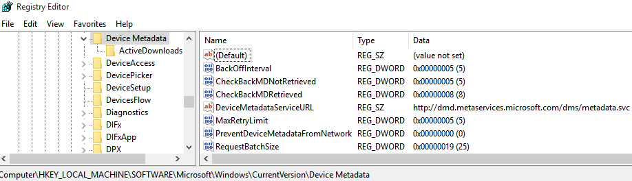

    The registry fix does indeed work in Win 10. Here is what the full key looks like...
    ...Set like that, the Administrative error 131 goes away. The badURL is the same in Win 10 as it was in Win 8.1:  http://go.microsoft.com/fwlink/?LinkID=252669&clcid=0x409
    I don't know whether there is something about originating from Win 7 that changes the pretty picture.
